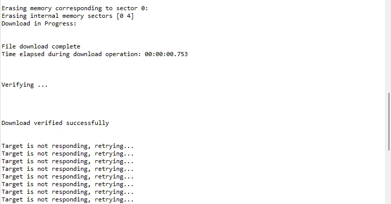

I’m working on a project with the STM32U5G9ZJT6, where I’ve implemented a bootloader in internal flash at 0x08000000. The application is stored in external OctoSPI NOR flash (MX66LM1G45G), which is memory-mapped to address 0xA0000000 using Octal STR mode.
I'm flashing the application binary into external flash using an external loader (.stldr) via STM32CubeIDE.
Although the application is successfully stored in external flash, when I try to execute it via memory-mapped mode, it fails (shows “Target Failed” or halts). I’m not sure whether it’s due to memory mapping, stack configuration, MPU, or something else.
Could someone guide me on the correct procedure or help me troubleshoot this issue?

Problem / Clarification Needed:
After jumping to the application, am getting below issue.

Hello @sravani
Please refer to example below:
STM32CubeU5/Projects/B-U585I-IOT02A/Examples/OCTOSPI/OSPI_PSRAM_ExecuteInPlace at main · STMicroelectronics/STM32CubeU5 · GitHub
This example describes how to execute a part of the code from a OSPI PSRAM memory.

Hello @sravani
