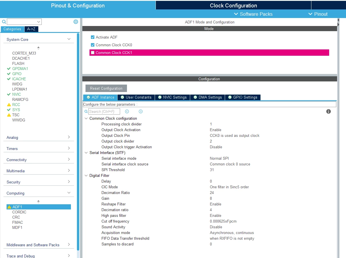

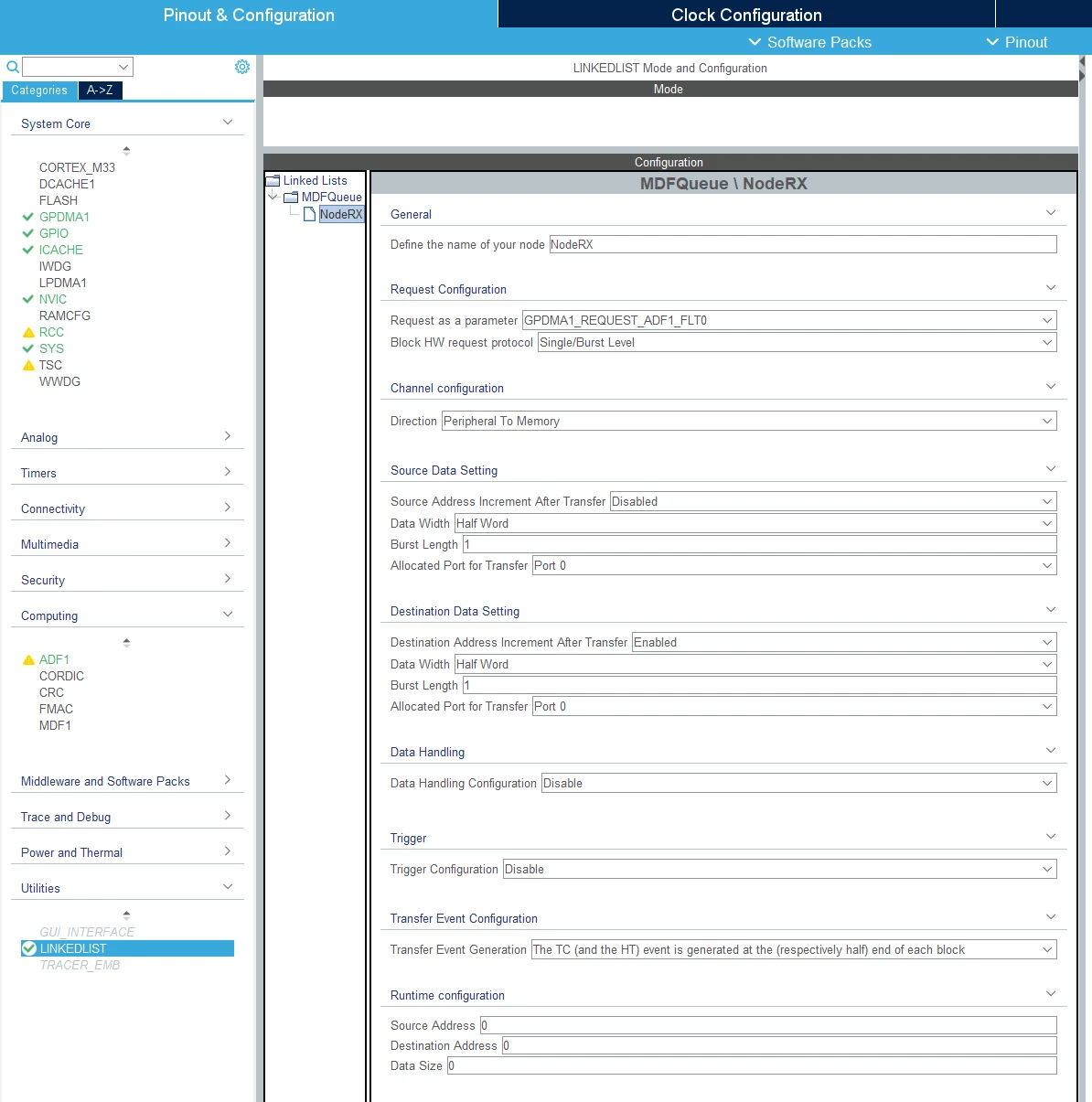

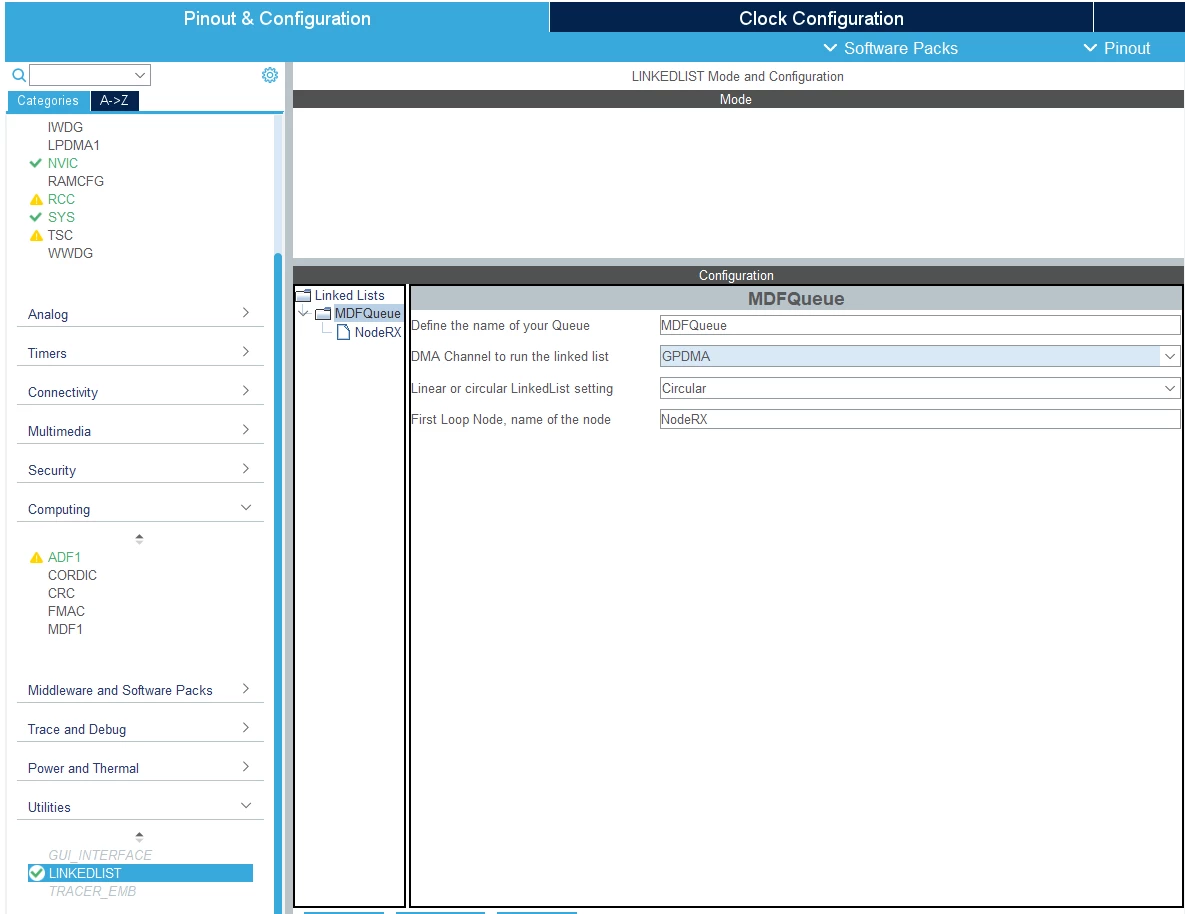

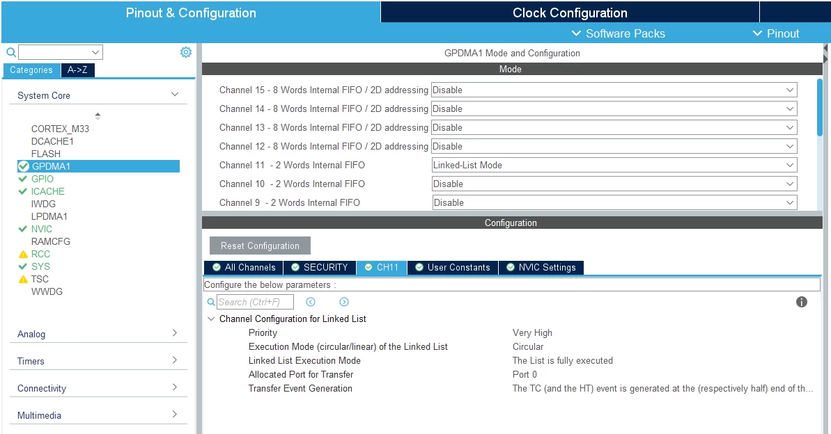

STM32U5 + ADF + GPDMA + STOPMODE1: Need help
I’m working on a project that involves reading audio samples from ADF1 and storing them in an internal RAM buffer using the GPDMA. The GPDMA is configured using Linked Lists in circular mode. An interrupt is generated when the buffer is half-full and full. The STM32 should remain in STOP1 mode while the buffer is filled, and wake up when either of the two interrupts occur.
Note that FatFs is also used to write the buffered data to an SD card through the SDMMC interface.
I have this all working perfectly on my custom STM32U575 pcb, but only when I put the STM32 into sleep mode. It does not work in STOPMODE1. The interrupts never occur and the device never wakes from STOPMODE1. What am I missing? How can I make this work? I’ve looked for existing example code using GPDMA and STOP1, but have come up empty. See below for CUBEMX configuration and code:
Most of my code is in the main() function:

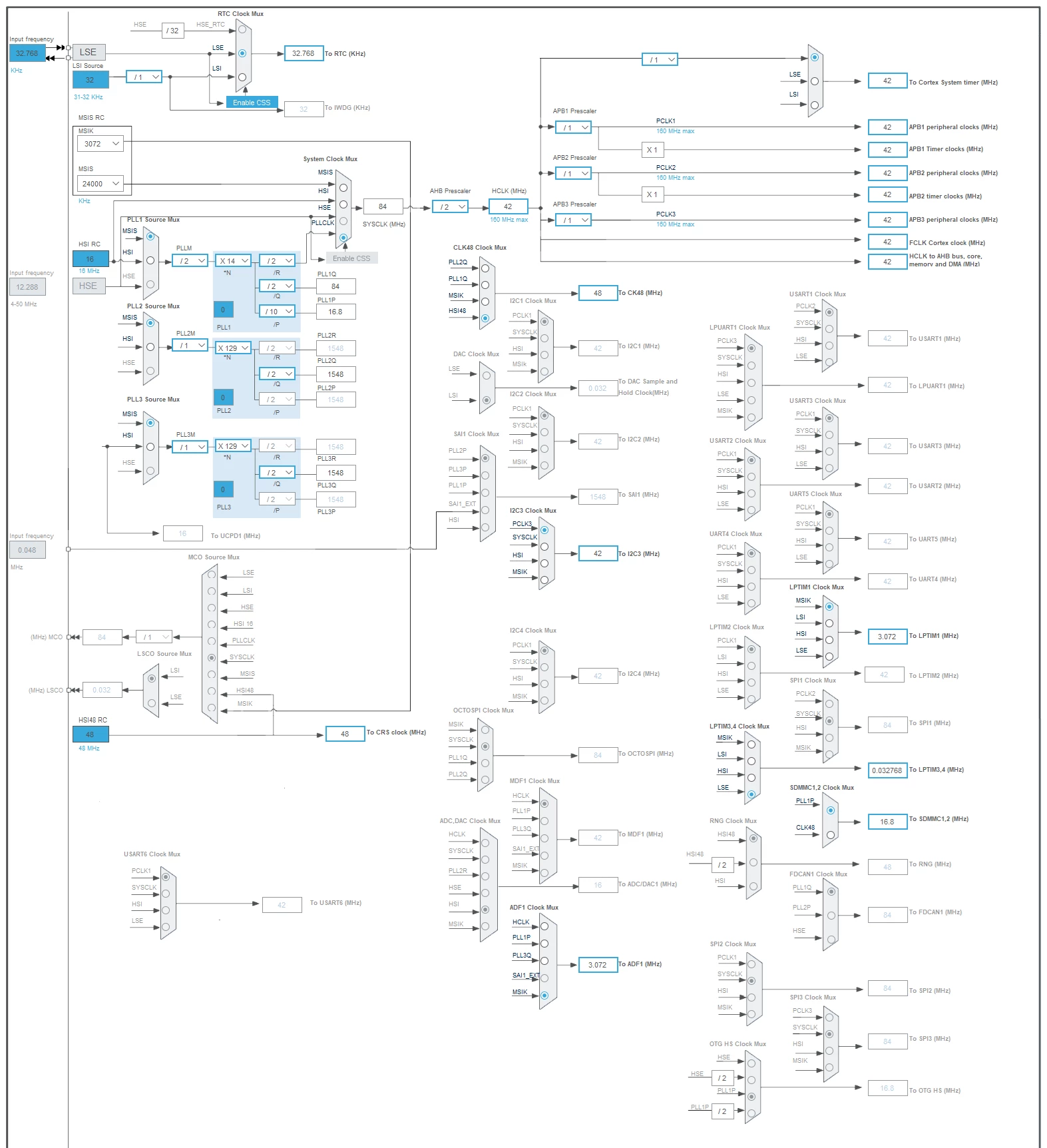

I was able to get this code working with LPDMA and STOP2 by learning from the "ADF_AudioSoundDetector" example that ST provides. However, due to some of the limitations of LPDMA and STOP2, I suspect my application might be more power efficient in STOP1 with GPDMA. I cant seem to find any similar example code for GPDMA and STOP1 however
The following is a screenshot of the Clock Configuration screen from CubeMX in case that offers any clues as to what I might be doing wrong
