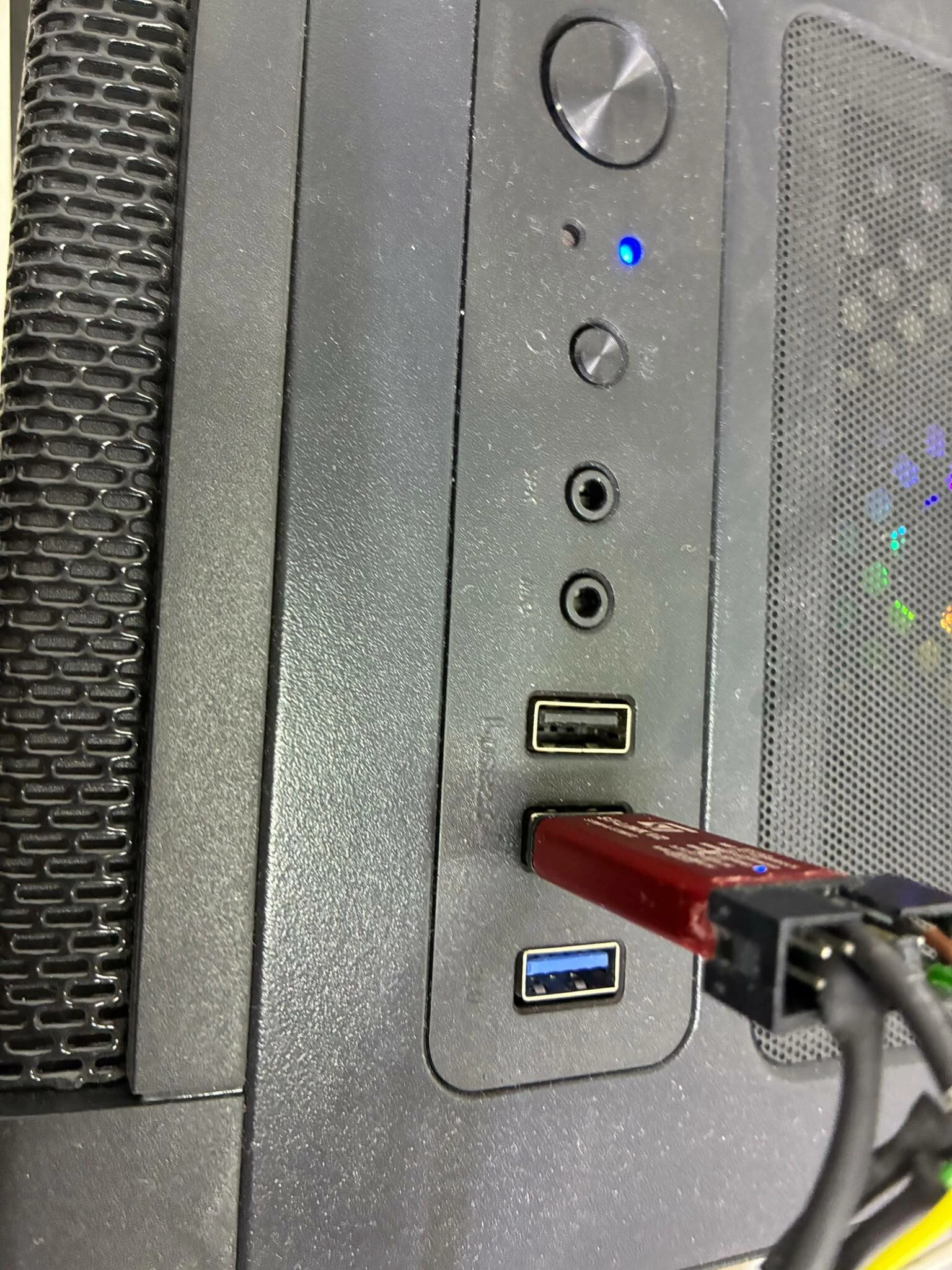

After continuous countless tries, i realize something and b.t.w i still does not know the reason why it fails and why is successfully seen by Windows. The first thing i want to explain is: I use my PC case front panel USB ports for this application for first tries as seen in 1st picture.
Front Case USB connection (I did not try blue colored 3.0 connection).

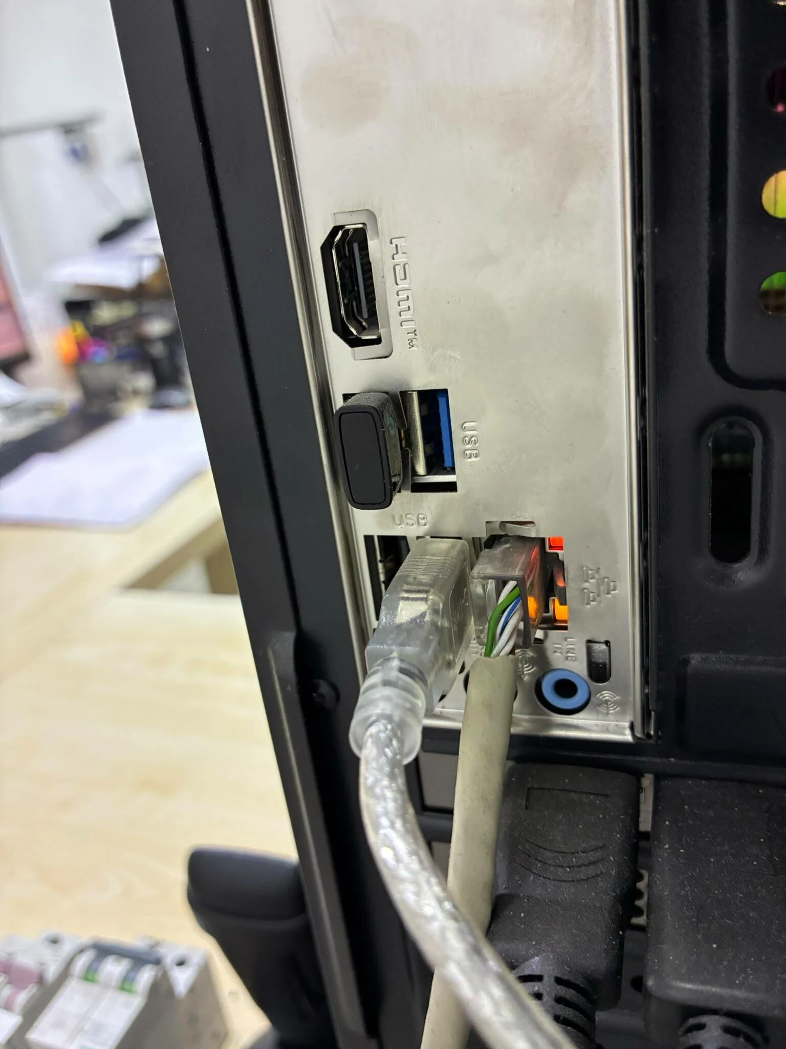

And second and in my opinion my successfull tries, i used USB port directly on motherboard like in second picture:
Motherboard USB connection(succesfull connection)
And when i use motherboard connection, i get successfull connection at the list of:
I still do not know why it was listed in “Bağlantı noktaları(COM ve LPT)” instead of:
And when i power my pcb with battery( 3.6V SAFT LS14500 Li-SOCl2 battery), i never successfully built usb connection. I have to do it with battery but i have no solution for it for now.
