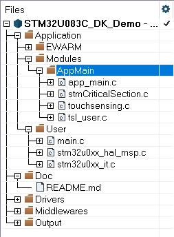

I have a similar problem with the demo package for STM32U083C-DK.
Using STM32CubeMX 6.12.1, I selected "New Project from a Board", Example Selector, filtered by STM32U083C-DK, and selected "Demo".

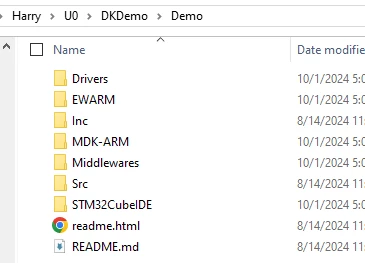

I chose "Start Project in external IDE" and chose a file path on my hard drive. In this case I chose "C:\Projects\Harry\U0\DKDemo". I chose Open with EWARM.
The project was copied to a sub-directory "C:\Projects\Harry\U0\DKDemo\Demo". This is what the first level of files looks like in the Demo folder:
The first problem when I attempted to "Make" in IAR version 9.30.1, compile error:
'C:/Projects/Harry/U0/DKDemo/Demo/main_app/app_main.c', needed by 'C:/Projects/Harry/U0/DKDemo/Demo/EWARM/STM32U083C_DK_Demo/Obj/Application/Modules/AppMain/app_main.o', missing and no known rule to make it
The project has an "AppMain" folder that has 4 source files that do not exist anywhere in the copied project.
If I delete these 4 files from the project structure then the Make operation gets slightly further. But then I get stuck at the same place as @RufusVS.
There is no file called "tsl_conf.h" in the downloaded folder structure.
How do we move forward? Are the "Modules" and "AppMain" folders and files intentionally removed from the demo  download package? Is the "tsl_conf.h" file supposed to be contained within the "Demo" folder structure or is there some external package or reference where that file is found?

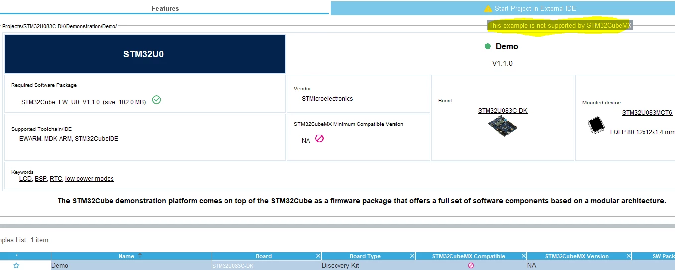

Hello All,
I reproduced the same behavior and escalated this to the appropriate team for analysis and take the necessary action via internal ticket ID 192710.
Note that the Demo is not supported by STM32CubeMX, and this mentioned in the warning when chose "Start Project in external IDE". Meanwhile, this will be fixed in the coming releases.

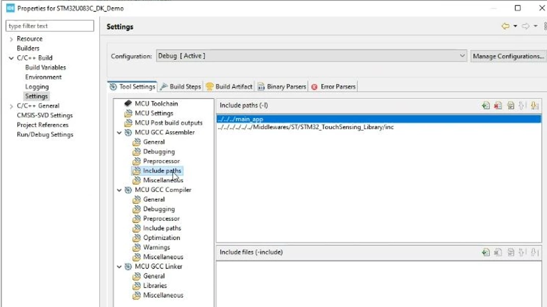

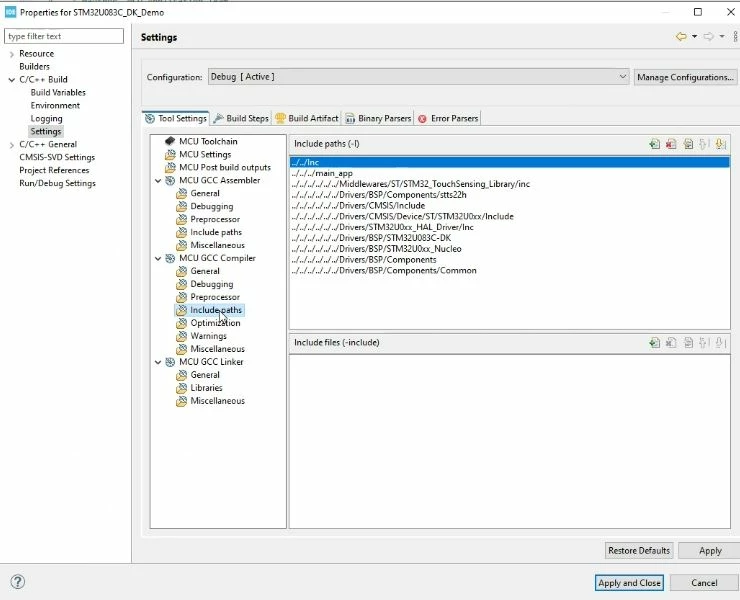

To properly generate the Demo application when open it with STM32CubeIDE, please make sure to have these settings in the Properties of your project:
