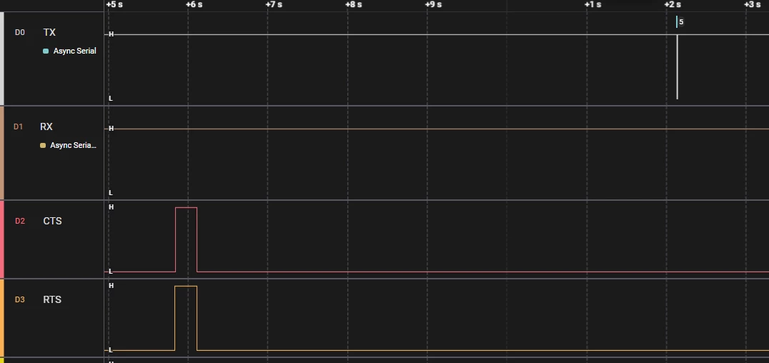

I would like to use LPUART3 to proceed the UART communication with hardware control flow enable.
However, I found that when the Send_UART_DATA  there indeed has TX signal from LA, but CTS/RTS hasn't changed, only when system reset, those two pins just could get the status changed.
Here is the configuration of MX_LPUART3_UART_Init()

And below is the print out log whenever trying to send the TX data
-First try after reboot---------------
LPUART3 IRQ triggered
Transfer completed callback
Started reception successfully
-2nd try after 1st time---------------
Failed to start reception
I would like to know whether the setting of configuration is unexpected? If yes, how should I fixed it?

I'm not seeing any issues with the signals you present.
> I was expecting there could be the status change which there is UART command be sent.
Why? There is no reason to expect this.
I don't understand the obsession with the RTS/CTS signals. If you are having functionality issues with the device, debug those directly.

Jun 9, 2025 5:15 PM UTC
Since RX is still busy, trying to call HAL_UART_Receive_IT again will result in HAL_BUSY. This is expected.
To fix: on call HAL_UART_Receive_IT again after the first operation completes. Remove it from the TX complete callback and call it in the main thread.

I assume that maybe the first issue need to be solve is that the RTS/CTS is not working properly.
So far, I still could not observed that there is RTS/CTS signal changed....excpet within reset
Jun 9, 2025 5:53 PM UTC
What about the RTC/CTS signals are you objecting to? Why do you think they are not working as intended?
The receiver controls RTS. A low signal indicates it's ready to receive. It's low in the plots and you are ready to receive. What's the problem?
CTS is low which indicates sending is allowed. You're sending.
Or am I missing something?

CYHAuthor
Jun 13, 2025 7:18 AM UTC
Hi @TDK,
Thank you for your support, after change to use DMA for RX function, the issue is sovled.
