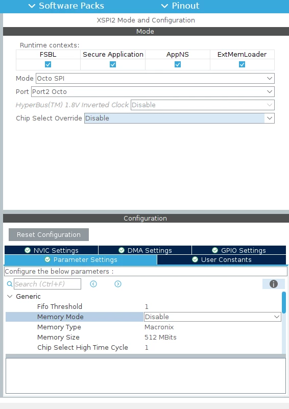

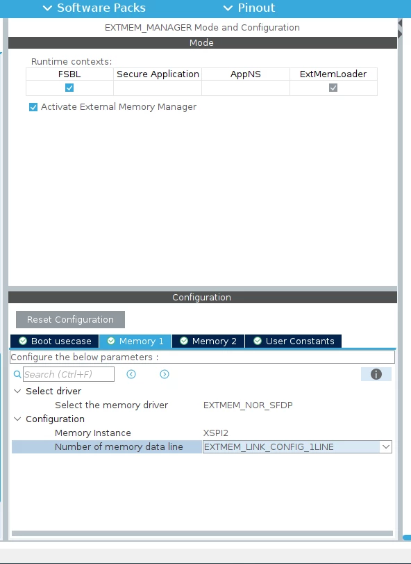

For a project i want to save log files in the external SPI of the Stm32n6 for this is already tried to configure xspi2 and the external memory, but i am not sure if i have done it right. I also have found no source on how to continue with the Code after this maybe someone can help with this.

Hello @Nixxen
Please check these examples below as starting point to configure your XSPI in CubeMX.
STM32CubeN6/Projects/NUCLEO-N657X0-Q/Examples/XSPI at main · STMicroelectronics/STM32CubeN6 · GitHub

Sometimes from examples is not easy to understand, and you have test the setup step by step by debugging, there is my working code, you just need to adjust PHY_LINK_1S1S1S by your flash type if you want to use 4 lines, in anyway if you use 1 line data mode then there must work without changes (I also attached files, I do not tested memory map mode), and I see what you do not use CS pin, you plan to switch manually ?
// include in inludes and declare object
#include "stm32_sal_xspi.h"
SAL_XSPI_ObjectTypeDef salXspi;
// test code in main loop
 	XSPI_ResetFlash();
 	XSPI_Init(&salXspi, (XSPI_HandleTypeDef*)&hxspi1);
 	XSPI_MemoryConfig(&salXspi, PARAM_PHY_LINK, PHY_LINK_1S1S1S);
 	HAL_Delay(1);
 	XSPI_EraseSector(&salXspi, 0, 0);
 	uint8 dbuff[256];
 // filling test buffer
 	for (uint8 n = 0; n < 32; n++) dbuff[n] = n + 1;
 // writing 32 bytes at 0x32000 address in flash
 	XSPI_WriteFlashData(&salXspi, 0x32000, dbuff, 32);
	uint8 rbuff[32];
	XSPI_ReadFlashData(&salXspi, 0x32000, rbuff, 8);
	printf("Fl %u %u %u %u %u %u %u %u\n", rbuff[0], rbuff[1], rbuff[2], rbuff[3], rbuff[4], rbuff[5], rbuff[6], rbuff[7]);
