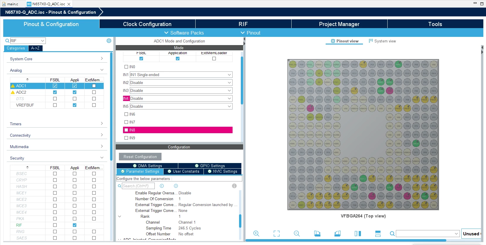

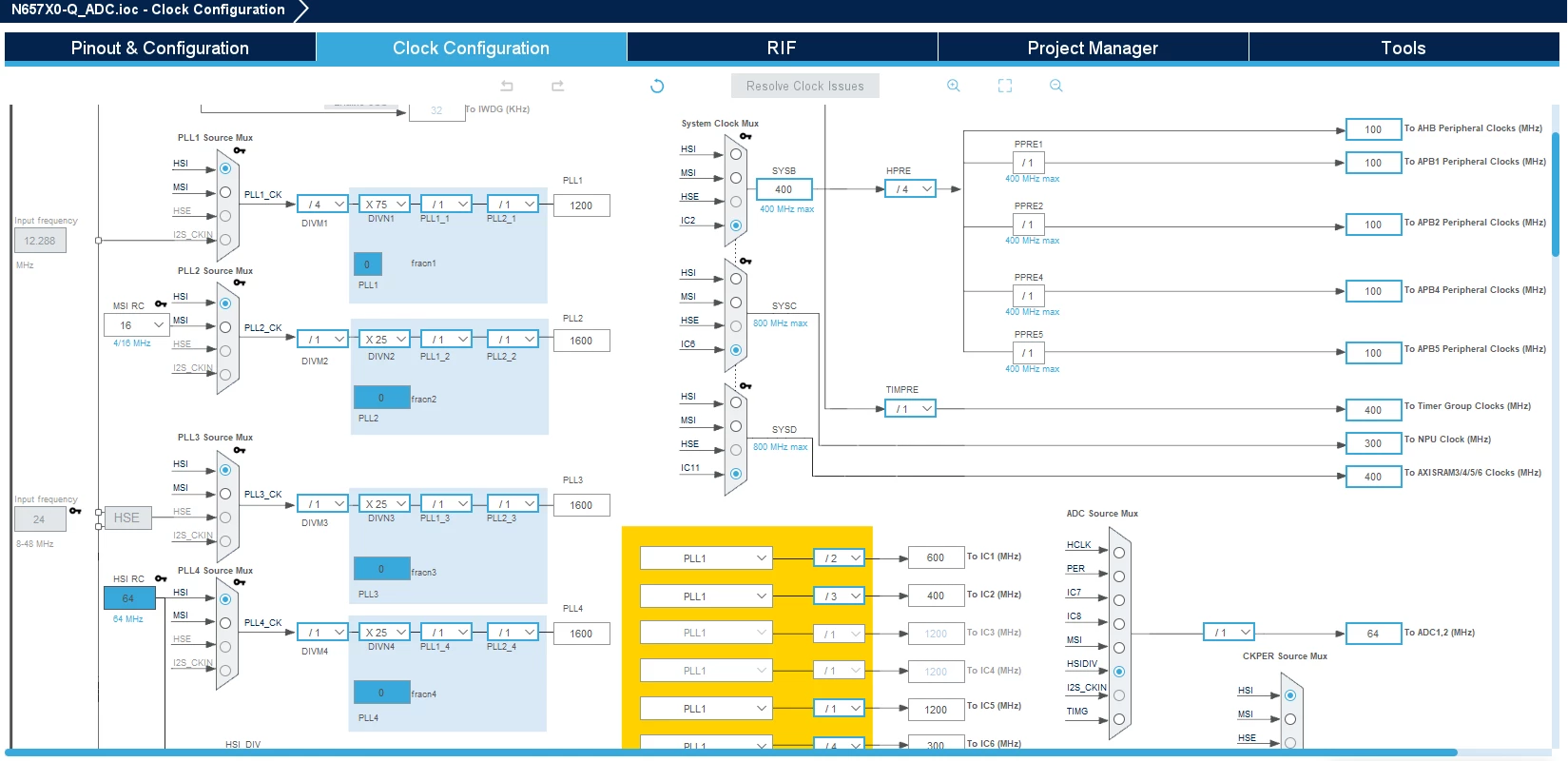

I am currently working on an analog sensor acquisition project using the NUCLEO-N657X0-Q (STM32N657X0) board on STM32CubeIDE (version 1.19.0). I am attempting to read a Keyes pressure sensor via ADC1 on PA1 (ADC1_INP1).
Physical Wiring & Setup
  • Sensor Connections: The pressure sensor is physically wired to:
    • VCC -> Board 3.3V
    • GND -> Board GND
    • Signal Out -> PA1 (bridged with a 1/2 resistor divider to ground to ensure the voltage never exceeds 1.8V).
  • CN12 Jumpers Connected:
    • Pin 13 / Pin 14 (VDDA1V8) is connected with a jumper cap to supply 1.8V to VDDA.
    • Pin 11 / Pin 12 (VDDIO) is connected with a jumper cap.
 STM32CubeMX Configurations

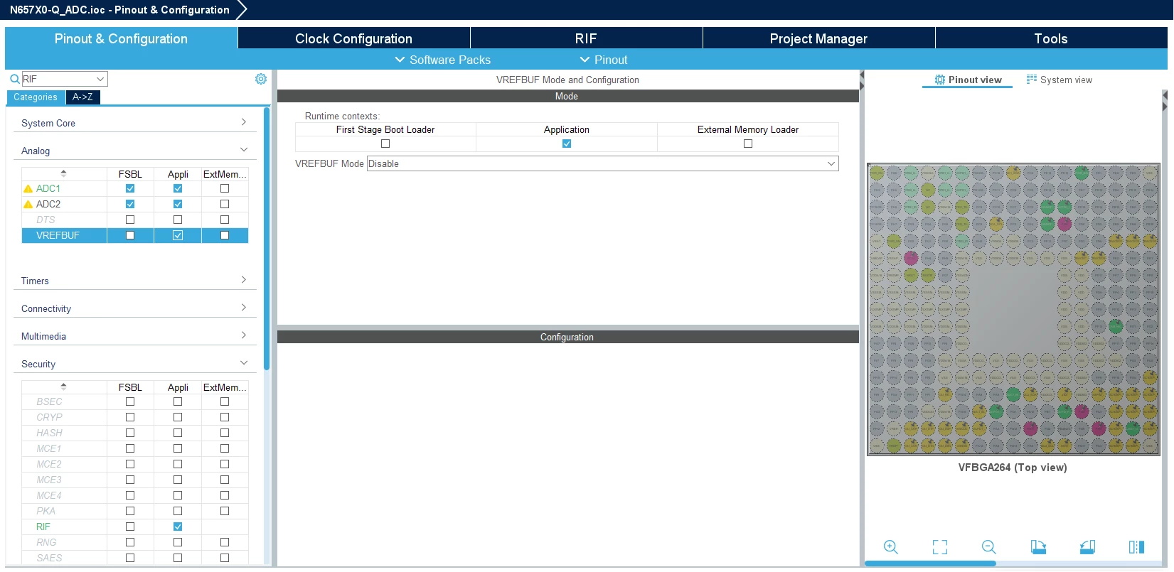

  1. VREFBUF: Configured as Disable (since the NUCLEO board provides an external 1.8V reference to VREF+).

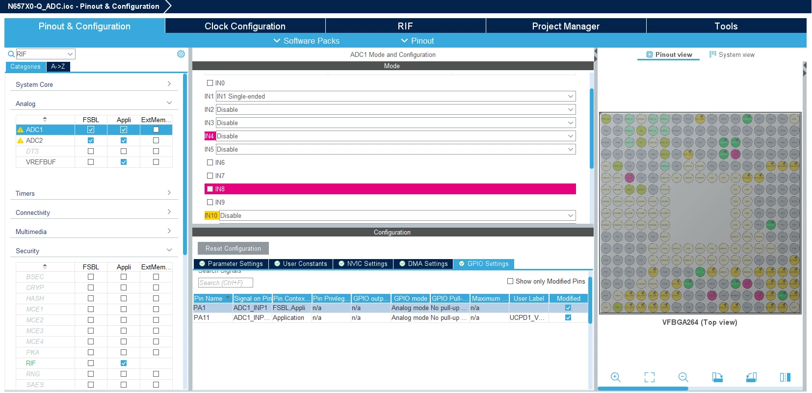

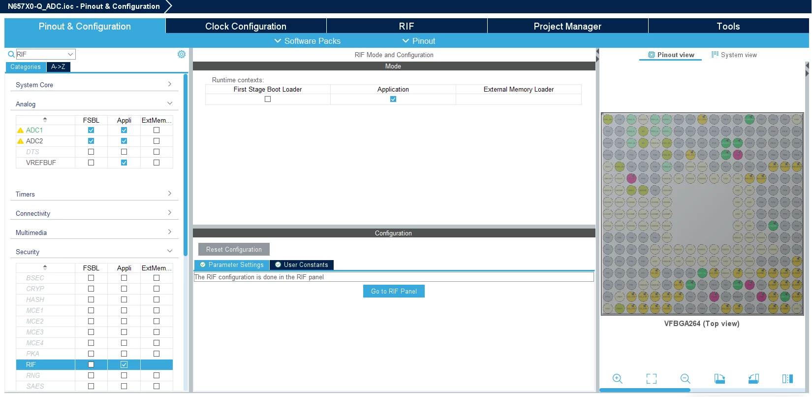

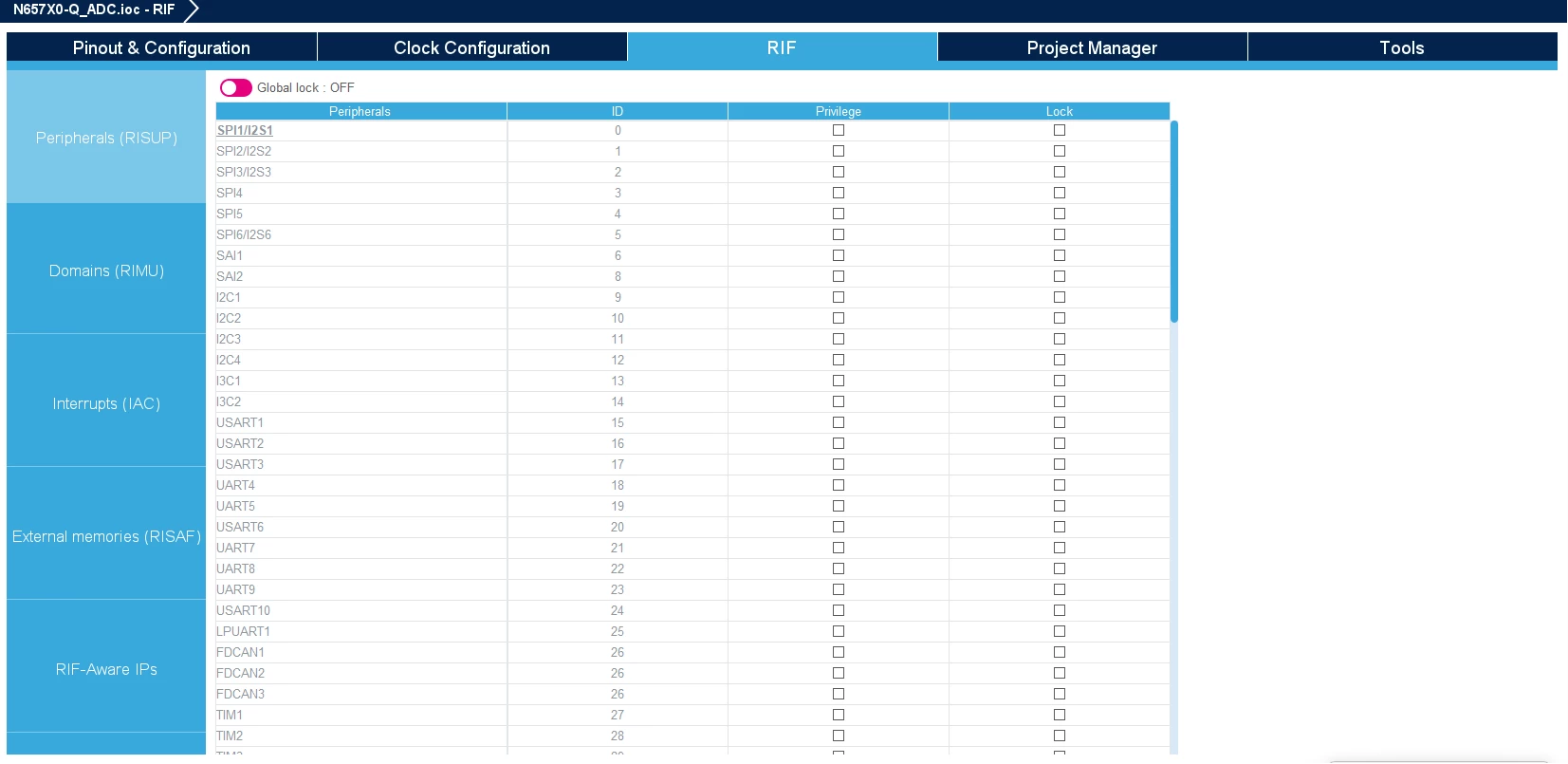

  2. Security & RIF (RIFSC Panel):
    • ADC1: Configured as Non-Secure, Unprivileged (unchecked), Unlock (unchecked), and assigned to the Application context.
    • GPIOA: Configured as Non-Secure, Unprivileged (unchecked), and assigned to the Application context.

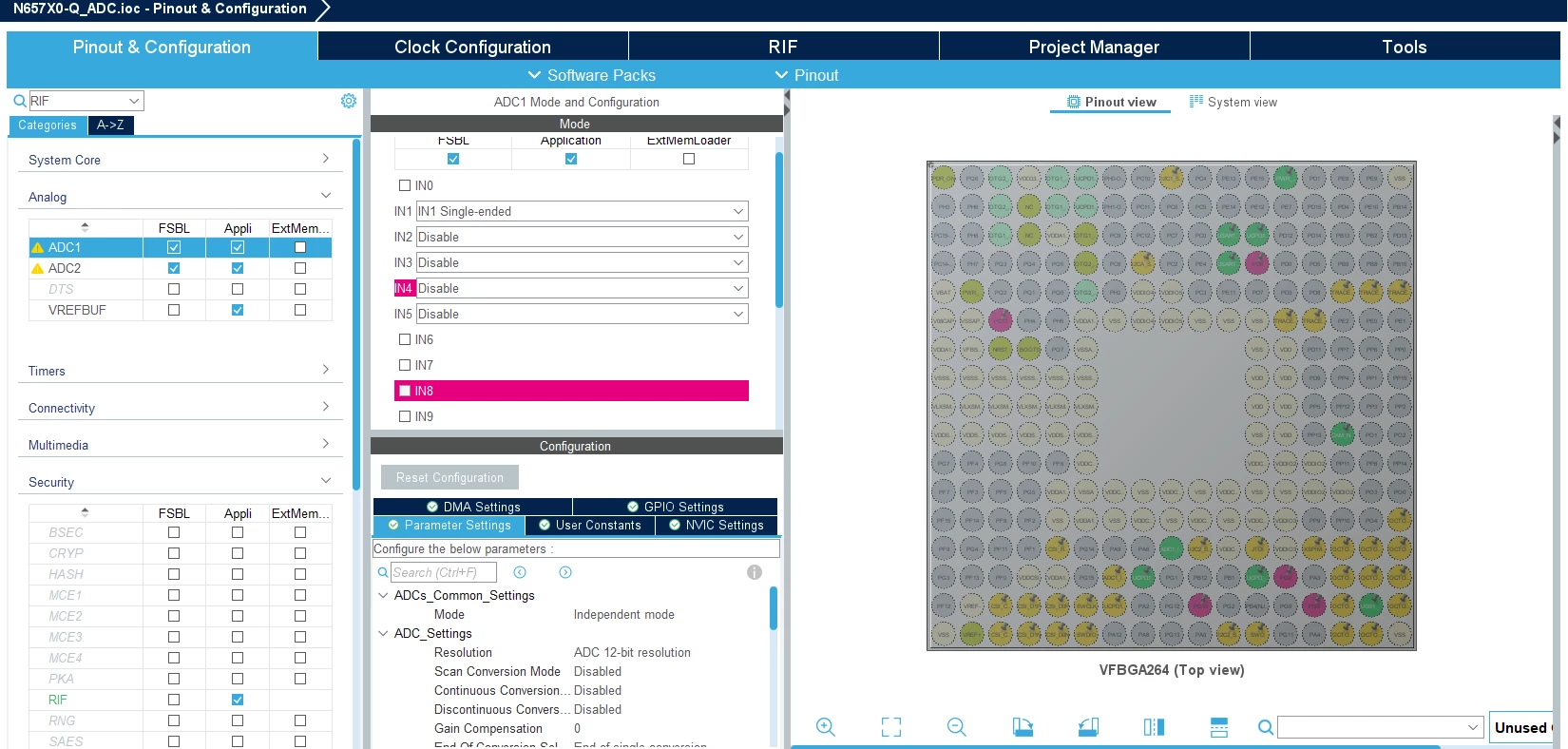

  3. ADC1 Parameters: 12-bit Resolution, Scan Conversion Mode Disabled, Continuous Conversion Mode Disabled, Software Trigger.
 Symptom & Error Logs
During system startup, HAL_ADCEx_Calibration_Start(&hadc1, ADC_SINGLE_ENDED) consistently fails and returns HAL_ERROR (Status Code 1).
When running the main loop, the returned values are always 0:
STM32N657X0-Q Keyes Pressure Sensor Demo
System Core Clock: 64000000 Hz
[VREF] NUCLEO-N657X0-Q board provides an external 1.8V analog reference (VREF+).
[VREF] Software bypassed VREFBUF (Disabled) to avoid Secure World register lock.
[ADC1] Starting hardware self-calibration...
[ADC1] WARNING: Calibration failed! Error Code: 1
-> 🚨 Please troubleshoot based on the following checklist:
1. [JUMPERS] Verify CN12 Pin 13 & Pin 14 (VDDA1V8) are connected with a jumper cap.
(R104 is OFF by default; bridging CN12 13-14 is mandatory to power the analog core!)
2. [JUMPERS] Verify CN12 Pin 11 & Pin 12 (VDDIO) are connected with a jumper cap.
3. [FIREWALL] Confirm ADC1 and GPIOA are configured as Non-Secure / Unprivileged in CubeMX RIF Panel.
4. [CLOCKS] Ensure 'ADC Source Mux' is pointing to a valid clock (e.g. HSIDIV, CLK_KER <= 50MHz).
[Keyes Sensor] RAW Value: 0 | Calculated Voltage: 0.000 V

Since the RIFSC has already been configured to assign ADC1 and GPIOA to the Non-Secure Application context, and the physical power rails are properly jumpered:
  1. Is there any additional system power configuration (e.g., PWR or clock gating) required to enable the ADC1 analog domain or internal voltage regulator for non-secure applications on STM32N6?
  2. Does the STM32N6 ADC hardware calibration require specific clock speed constraints or a specific prescaler setup to pass?
Any advice, hints, or ADC reference examples for the STM32N6 series would be highly appreciated.
Best regards,
3 replies
Jul 16, 2026 13:20 UTC
Hello, members of the ST community!
I am developing an application on the NUCLEO-N657X0-Q (STM32N657X0) using the STM32Cube IDE. I am attempting to read data from a pressure sensor (Keyes FSR) via ADC1 (PA1).
Problem: My code is getting stuck at the point where HAL_ADCEx_Calibration_Start(&hadc1, ADC_SINGLE_ENDED)returns a HAL_ERROR((code 1). The raw value is always 0.
Current configuration and debugging steps
  1. Hardware:
    • I have verified the physical connections on CN12((pins 13/14 of VDDA1V8 and pins 11/12 of VDDIO are connected via jumpers).
    • I have confirmed that the sensor input voltage is within the 0–1.8 V range.
  2. CubeMX RIF settings:
    • I have accessed the RIF panel in CubeMX.
    • For ADC1 and GPIOA: I have ensured they are set to ‘non-secure’ mode and have assigned the runtime context to ‘Application’. I have also disabled the ‘Privileged’ and ‘Locked’ attributes.
  3. Software Configuration:
    • VREFBUFmode is set to disabled, as the board provides an external 1.8V reference voltageVREF
    • ADC1 is configured in single-ended mode.
Issue: Despite disabling VREFBUF and setting the RIFSC permissions for ADC1 and GPIOA to the application context, hardware calibration still fails with HAL_ERROR (1)。
ADVREGEN I suspect that the internal voltage regulator of ADC1 in the STM32N6 series may have hidden RIF restrictions or a specific initialisation sequence, which differs from previous STM32 generations.
Could you please provide guidance on the following
  1. Is additional RIFSC or system-level configuration required to run ADC1 in non-secure mode on the STM32N6?
  2. Is there a recommended initialization sequence for ADC1 on the Cortex-M55 core to ensure the internal analogue LDO is correctly initialized prior to calibration?
Attached are my RIF configuration and initialization code snippets. Many thanks for any advice you can offer.
Yours sincerely, Michael Hong
