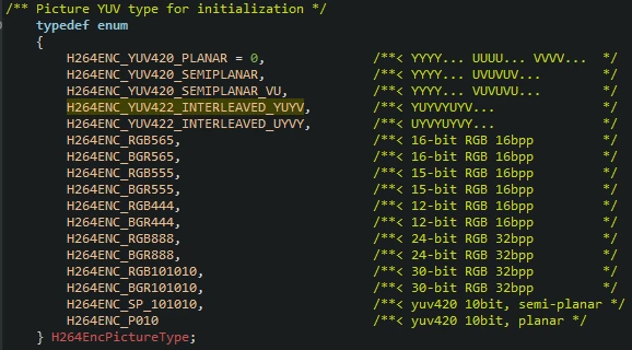

1. What is the input data format of the H.264 encoder (VENC)?
   Is it receiving YUV420/NV12 from DCMIPP, or some other format?

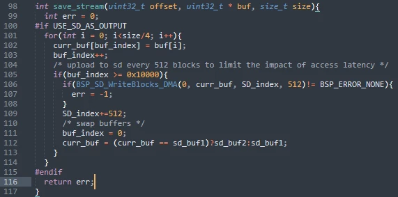

3. Is there any example or documentation that shows how to use the H.264 encoder output without RTP/RTSP?
   For example:
       Camera → DCMIPP → VENC(H264) → SPI
I only need to  sending the encoded H.264 data through SPI to another controller.

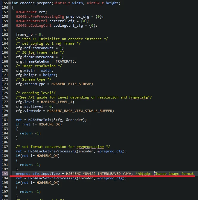

1. The VENC input format can be adjusted in the `encoder_prepare()` function:
Options of input types:
This would be based on your camera output of course. For debugging perhaps extract the preprocessed frame memory and view to verify it matches the expected encoder format.

3. The VENC_SDCard example uses the `save_stream()` function to save the data to the SDCard. You could do something similar and send over SPI here instead.
