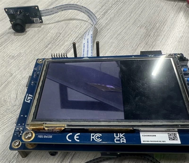

I have successfully deployed the VENC_SDCARD example on the board and can see its feed on my laptop. Now, I want to record it at 480x480 resolution instead of the default 800x480 provided in the example.
I have modified the buffer size, DCMIPP, LTDC configurations, and made a few additional changes. I’m attaching my main.c and stm32n6570_discovery_lcd.c files for your reference.
The following is my camera feed.

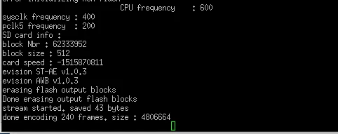

and these are the debug statements in the uart terminal.
which looks fine to me with no errors.

This example was intended to be simple but, unfortunately, it was also hardcoded.
Please find attached a slightly modified version.
I tested it successfully with a resolution of 480x480.
Hope this helps.
