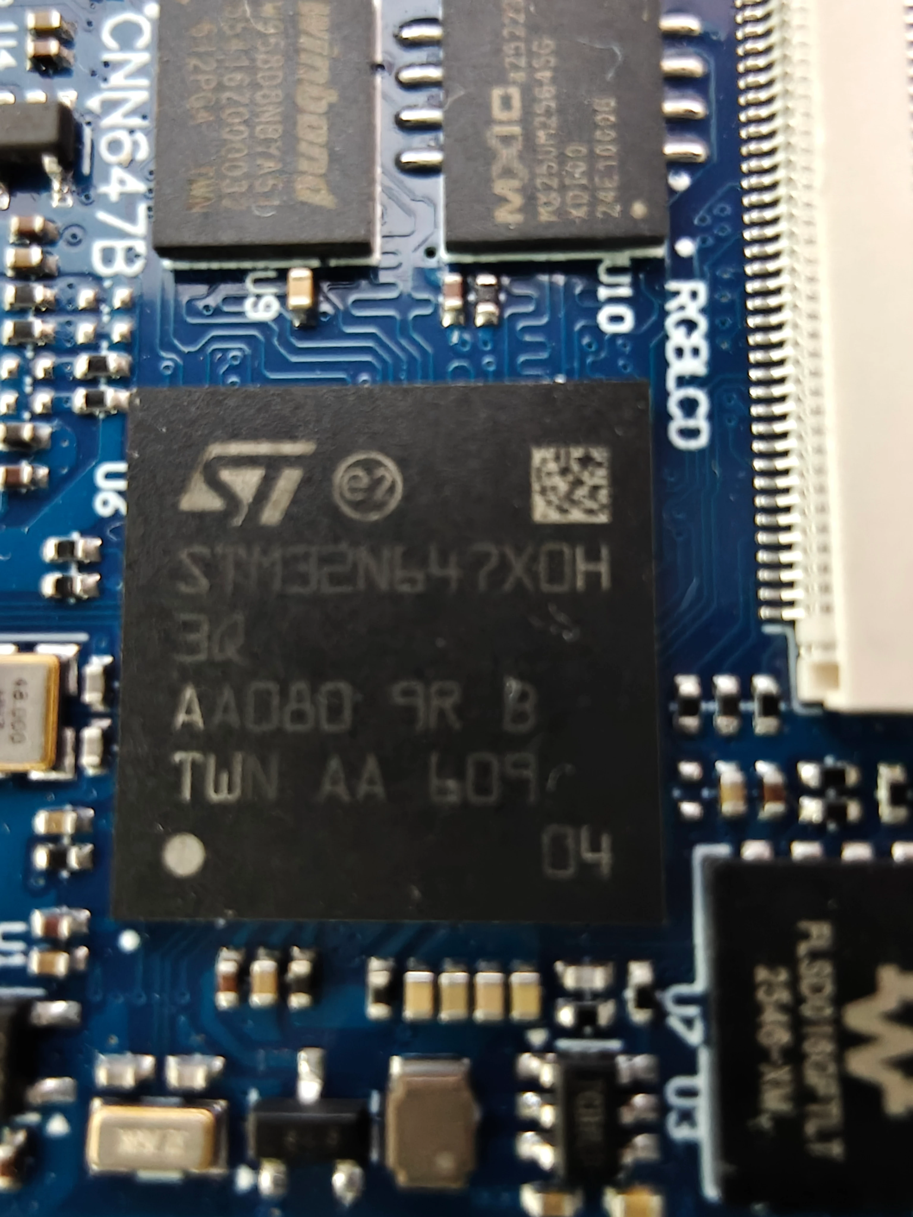

Aug 14, 2026 10:07 UTC
Hello ​@xukong ;
Which STM32N6 revision are you using : Rev.Z or Rev.B?
To check the device marking, please refer to “Reference device marking schematics for STM32 microcontrollers and microprocessors” (TN1433).
Thank you.
Kaouthar
xukongAuthor
Aug 17, 2026 00:51 UTC
KDJEM.1
