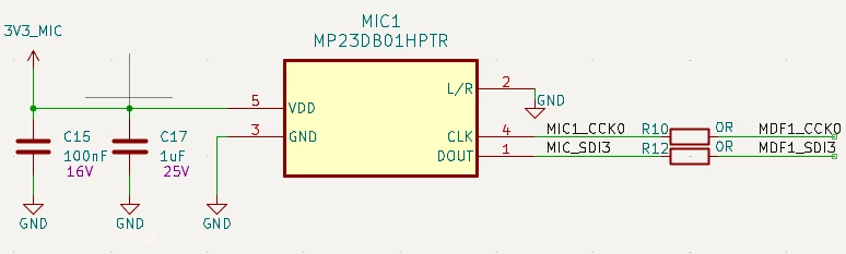

I’ve connected a MP23DB01HPTR MEM MIC to the STM32N6 Nucleo’s MDF1_SDI3 and MDF1_CCK0 and here is my connection.

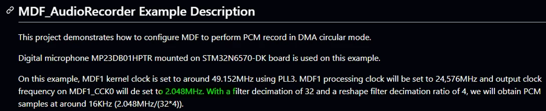

I am using“ Projects/STM32N6570-DK/Examples/MDF/MDF_AudioRecorder” as a reference and according to the information on Github, the CCK0 should be 2.048 MHz

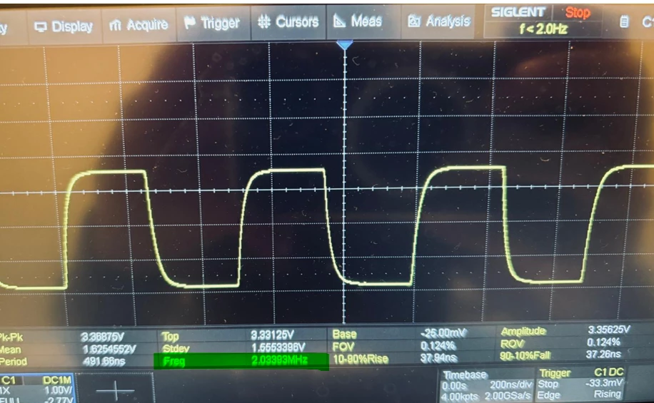

Which I am measuring almost the same frequency on the CCK0 pin of my board : 2.03393 MHz

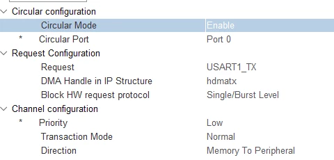

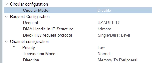

One thing I noticed my USART Tx mode is set to “ Circular Mode” , and I think this is a wrong setting, Is that correct ?
As an experiment, I disabled the Circular mode, and I noticed the USART 1 only send out 4096 bytes ( 2KB). After that the USART stop working, however MDF callback is working as I am toggling an LED.
I would appreciate if someone could review my problem and let me know what the issue is ?

Listening to ​@Saeid .wav recording the mic is picking up a lot of noise from the running MCU PCB, it is most likely coming to the mic via power and signal lines:-
you could go through these suggestions:-
  1. make sure your serial comms is at a reasonable speed like 1 MBaud or even less.
  2. provide an independent clean power supply to the mic (and well decoupled)
  3. set the MCU ports communicating with the mic for slow transitions
  4. use opto isolators for the serial comms to the mic with lowest working baud rate
  5. check standard designs for connecting mems mic’s
Hope that gives you some ideas.
