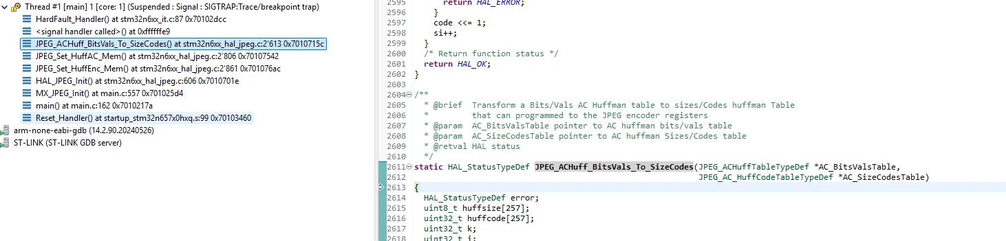

I have a bit trouble initializing the JPEG peripheral on the N6. See the stack trace:
I feel like this has something to do with the RIF? I don’t know, this chip is very new to me. If anyone can help me, it’d be greatly appreciated.

Okay, so I essentially fixed the initialization issue.
The Problem
In my case, I added the JPEG code to an existing application that made use of the NPU via. generated files from STM32Cube AI Studio. To make use of that generated code, I had to expand my linker script with the provided one by the AI Studio; so I basically expanded my MEMORY region, to match that of the generated .ld file:

The Fix
I didn’t see that the generated .ld file also increased the _Min_Heap_Size and _Min_Stack_Size, so I additionally updated those:
_Min_Heap_Size = 2048; /* required amount of heap */
_Min_Stack_Size = 8192; /* required amount of stack */

Thanks for the suggestion, I will look into that. In the meantime, I tried to use the example ‘JPEG_EncodingFromOSPI_DMA’ and that also HardFaults at the same location…
=> Which is because of my linker script, lol
