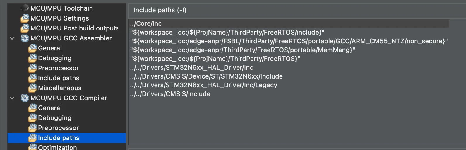

@Saket_Om This solved the privileged calls but Im hitting the next obstacle with `undefined reference to `MPU_xTaskCreate'`.
Im creating a task using `xTaskCreate` which gets redefined at https://github.com/STMicroelectronics/x-cube-freertos/blob/b0f4a6681bd37b483076db2e8171239db9dacbb1/Middlewares/Third_Party/FreeRTOS/Source/include/mpu_wrappers.h#L100.
From what I gather, this `MPU_xTaskCreate` is defined at https://github.com/STMicroelectronics/x-cube-freertos/blob/b0f4a6681bd37b483076db2e8171239db9dacbb1/Middlewares/Third_Party/FreeRTOS/Source/include/mpu_prototypes.h
I have added the `include` folder into my GCC compiler path so not sure why it would not be able to find the `MPU_xTaskCreate`?

Hello @milanvdm
Is this flag "configUSE_MPU_WRAPPERS_V1" is set to 1 on your project?
Compiler cannot find "MPU_xTaskCreate" if this flag is not set to 1.
#if ( configUSE_MPU_WRAPPERS_V1 == 1 )
 BaseType_t MPU_xTaskCreate( TaskFunction_t pxTaskCode,
 const char * const pcName,
 const uint16_t usStackDepth,
 void * const pvParameters,
 UBaseType_t uxPriority,
 TaskHandle_t * const pxCreatedTask ) FREERTOS_SYSTEM_CALL;
