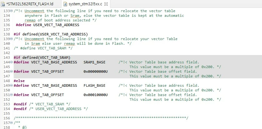

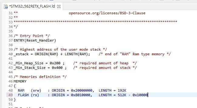

I changed the main code setting like this.
0693W00000HqSl7QAF.jpg0693W00000HqSlCQAV.jpg​
I'm want to jump from 0x8000000 bootloader to 0x8010000 main firmware.
There's an error in the jump.
I downloaded the firmware with a cubeprogrammer.
In this case, how should I solve this?

Try to set Jump variables in "static" like this:
static pFunction Jump_To_Application;
static uint32_t JumpAddress;
I had the same issue using STM32L562VET6 and ARM Compiler V6 on Keil.
