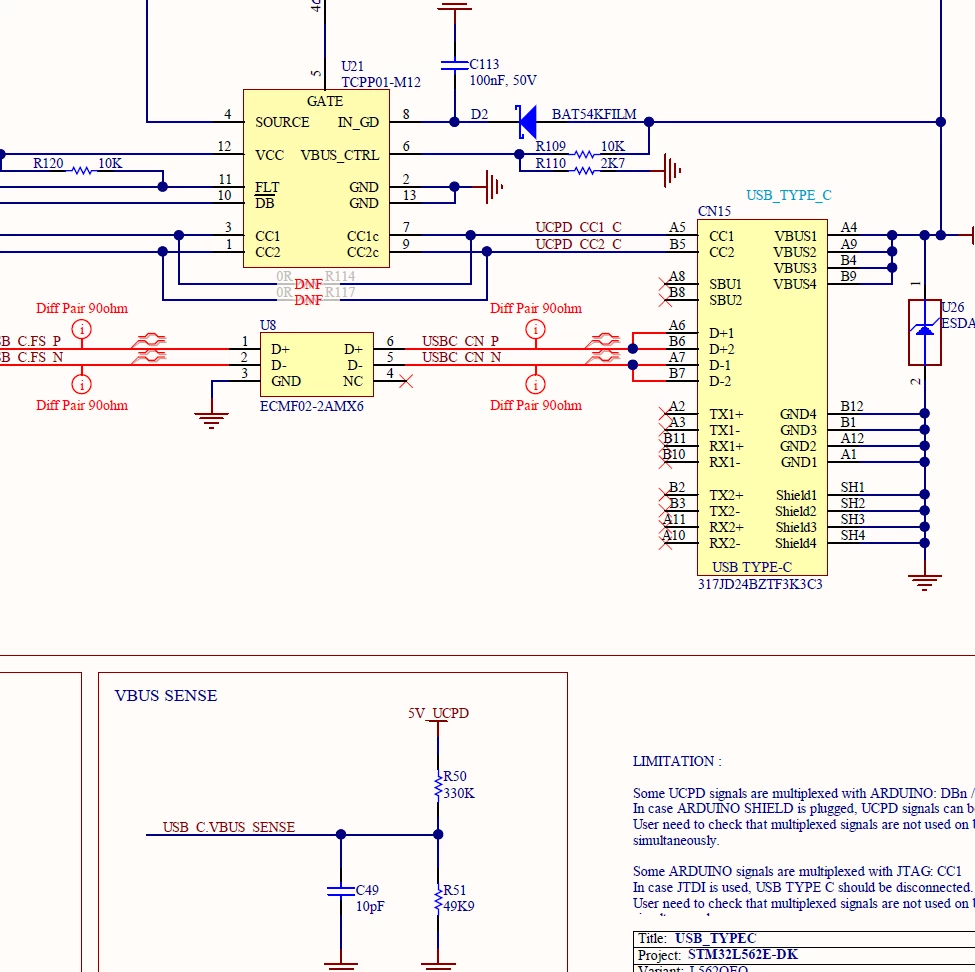

Hi Team,
I have STM32L562 EDK with me , and can i make a USB PD application with that alone ?, or should i buy x-nucleo-snk1m1 which has TCPP01 for port protection?

Hello @NITHIN
No need to buy a shield, the TCPP01 is already on the STM32L562E-DK
And as @FBL pointed out, there is already a firmware project available.

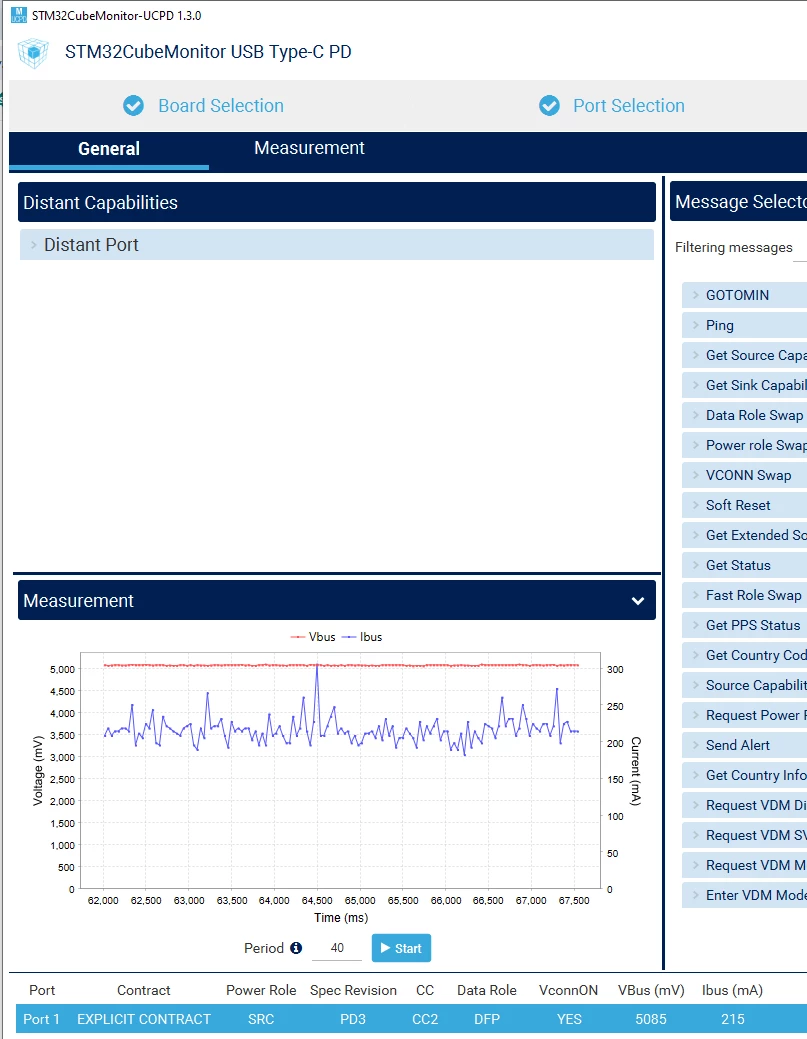

One more doubt, Can i take advantage of the inbuilt screen for monitoring the power consumption via USB PD?
Thanks in advance

Hello @NITHIN,
You want to display board power consumption on inbuilt screen ?
It would perhaps increase the power consumption a bit ? How precise do you want to be ?
And what do you mean power consumption via USBPD ?
If you want to have the details of the power delivery contract, you can have that on the UCPD monitor.
Are you aware of this tool (wiki link) ?
You can display VBUS voltage and current :
Or even use the trigger button to display some info in the trace : see this part of the wiki
