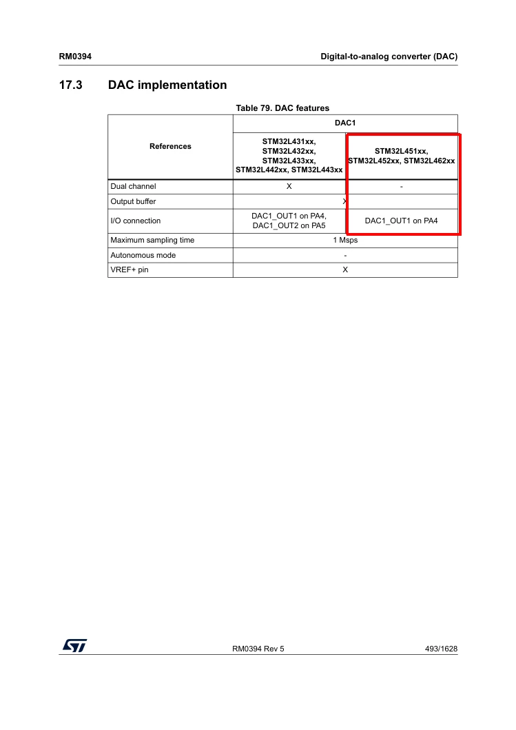

Based on discussion here, conclusion is, that given in 'L45x/'L46x there's no DAC1_CH2, and in 'L41x/'L42x no DAC at all, these are unavailable for inputs selectable for COMP for these sub-families of the low-end 'L4xx family group handled collectively by RM0394.

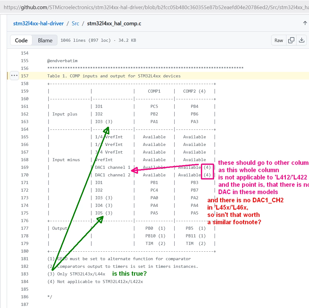

Description in stm32l4xx_hal_comp.c does not tell these completely, and there are also references to 'L43x/'L44x having some exceptions, which based on RM/DS doesn't appear to be the case:
Also, macros in stm32l4xx_ll_comp.c don't take the missing DAC channels into account, and they should.
Can these be looked at, please.

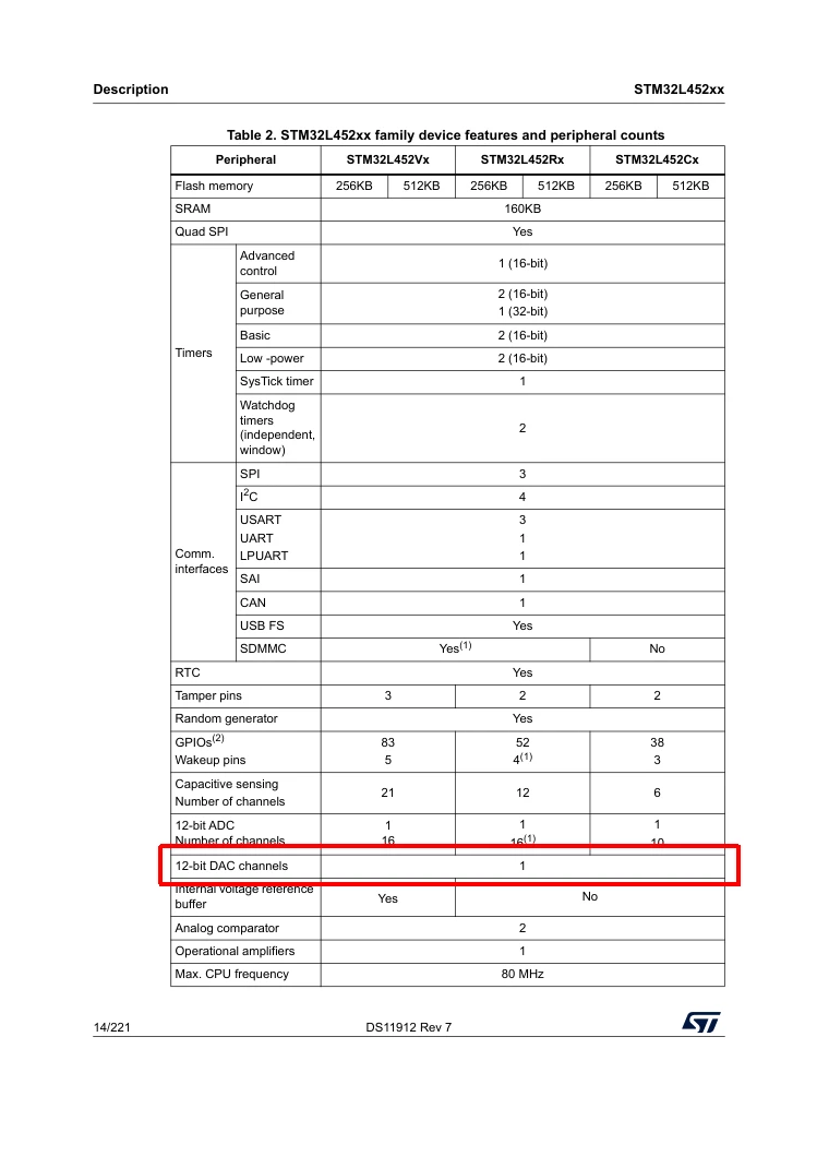

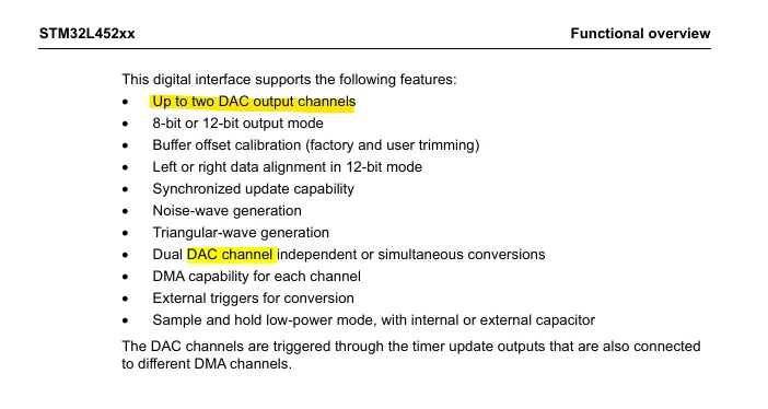

Hello @waclawek.jan
According to the datasheet of L452 there is two dac channels for this MCU.
 Could you explain more about this point please?

waclawek.jan
September 15, 2026
Hi @Saket_Om ,
Also, there is no DAC1_OUT2 in the pin definitions tables in 'L451 nor 'L452 DS.
If this is true, the IS_LL_COMP_INPUT_MINUS macro in stm32l4xx_ll_comp.c should have a different variant for the 'L45x/'L46x, omitting the option to use  LL_COMP_INPUT_MINUS_DAC1_CH2.
