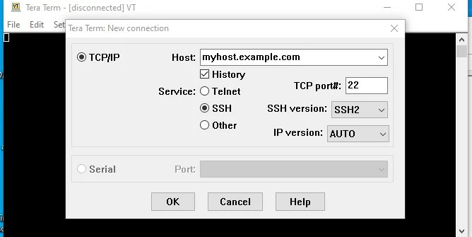

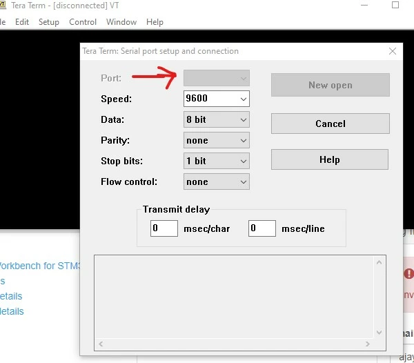

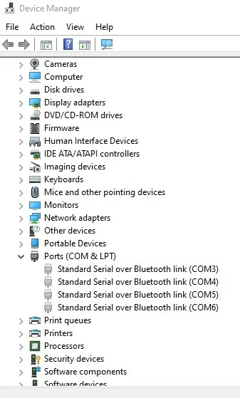

When I plug this device into Windows 10 machine, I am not able to connect to the device. I do not see any COM port in Device manager and also Tera Term serial port option is greyed out.

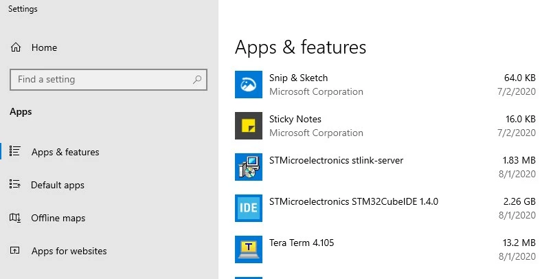

I did install STSW-LINK009. I have tried this is 3 windows device and getting same issue.
I noticed that Red line is blinking on the board, while green light is stable.
Device manager
Tera term
Installed ST programs

Actually I have tried this on 3 windows machine connecting with all USB ports available.
