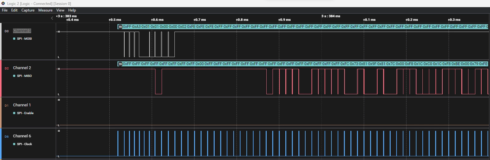

I don't quite understand what you mean by displaying the interactions I'm receiving via a serial port. I'm not quite sure if I can use the serial port and the mass-storage device at the same time. One thing I tried out was connecting the four functions used in the usbd_storage_if.c file with LEDs and see, if they receive a valid return from the FAT FS Functions.
I could see that SD_disk_read worked and returned a 0 (USBD_OK). Removing the sd card while the program was running made the LED stop blinking (therefore returning a USBD_FAIL or something similair). Meanwhile, SD_disk_write is never used, aswell as the function STORAGE_Write_FS in usbd_storage_if.c.
I've tried to display the SD-Card SPI via a logic analyzer, but I'm not quite sure what I've to expect:
Kind regards
