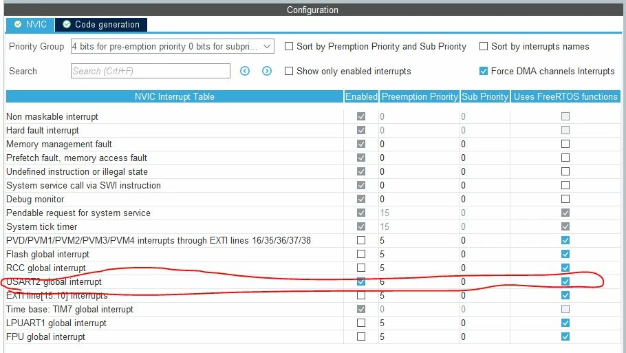

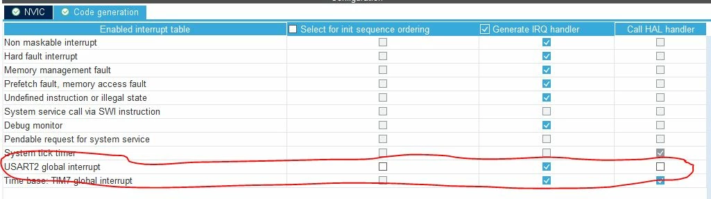

Hello Everyone,
I am currently working with a dev board based on STM32L4R5 using STM32CubeIDE , HAL libraries and FreeRTOS.
Project: UART2 initialized using the code generator:
Added __HAL_UART_ENABLE_IT() after initialization.
Along with this disabled the " Call HAL Handler " for the USART2 IRQ0693W00000BavyZQAR.jpgAlso modified the IRQ priority0693W00000BawFoQAJ.jpgI have also initialized an queue that is used to send data from the UART IRQ and then received by a task/thread.

Issue:
When I comment out the line:
osMessagePut( USART2_RxQueue, rxData, 0 );
There is no issue encountered. But when the Line is added, the HAL_Init() function does not return.
From basic debugging the problem lies here in the HAL_Init()
 /* Use SysTick as time base source and configure 1ms tick (default clock after Reset is MSI) */
 if (HAL_InitTick(TICK_INT_PRIORITY) != HAL_OK)
 status = HAL_ERROR;
 else
 /* Init the low level hardware */
 HAL_MspInit();
Could someone please let me know If I am doing something wrong here.

Hello @POval.1​ ,
Can you please share your example for further check ?
Thanks in advance.

I am encountering the exact same issue with the nucleus F443ze board. Have you find the solution?
Visitor II
Jun 8, 2024 2:27 PM UTC
I found the solution for my case, i forgot the enable the USE_NEWLIB_REENTRANT setting for Freertos in cubemx.
