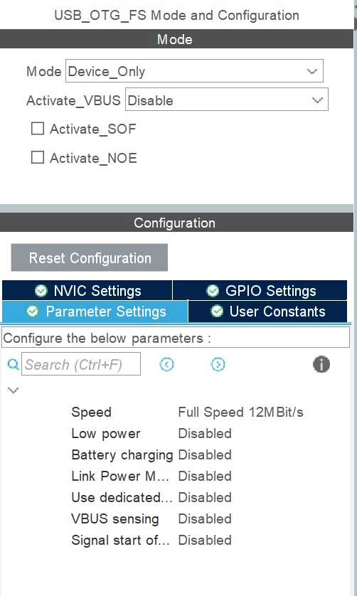

The software is generated via the .ioc file. I used the USB_DEVICE package. And tested it with and without V_USB sensing.
The settings: Device_Only, Full Speed and is configured as CDC.

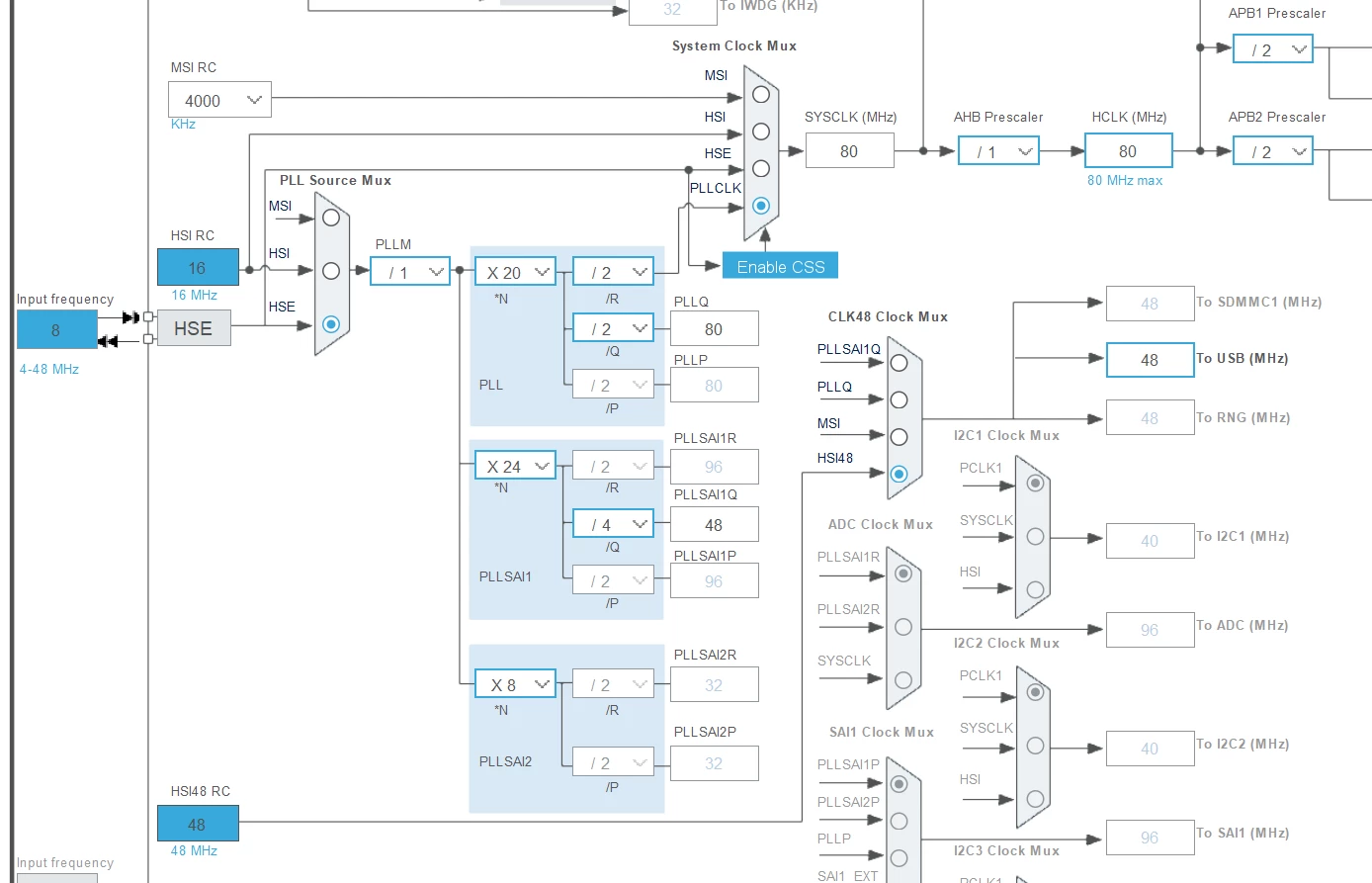

- I have checked the clocks. I am using HSE with an 8MHz oscillator. The microcontroller is running at 80MHz. I tried the HSI48 and 48MHz over PLL as input for the 48MHz clock for USB, but nothing changed. Looked into the code, __HAL_RCC_USB_OTG_FS_CLK_ENABLE() is called.

Disable VBUS sensing - it's not needed for basic app.
Reset means that the device was detected by host, so don't worry about pullup.

I disabled the VBUS sensing and doubled (and tripled) the stack and heap size. Nothing...
I also checked the USB communication with wireshark. No packets were send if I connect the USB cable.
I activated the NOE Pin. If i measure correctly (have at the moment only  a voltmeter, but all pins left and right are not used) the pin drives 3.3V.
There is not much information about the NOE-Pin, but if this is correct (https://community.st.com/t5/stm32-mcus-embedded-software/usb-noe-what-is-it-for-exactly/td-p/90891), the pin should be low if the USB-PHY is active.
So my USB-PHY is not enabled...

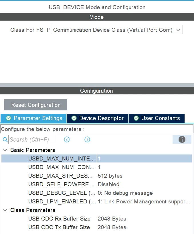

I attached my .ioc settings:
Do you have any other ideas?
