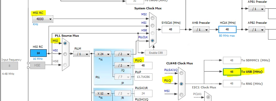

jacob2
jacob2Author
October 13, 2016
Posted on October 13, 2016 at 17:57
Here is the configuration for the EVAL-Board, as you can see it still bases off of the MSI clock. In my board configuration, it is slightly different where instead the MSI is configured for 48 MHz and passed directly to the clock for USB.
stm322399
Senior
October 13, 2016
Posted on October 13, 2016 at 18:29
The pro of the EVAL board config is that the last divider might deliver a cleaner duty cycle than feeding directly from MSI.
I already worked with an USB IP requiring 96MHz (that will be internally divided to 48MHz). The documentation saying that it has been done so to get a very clean 50/50 duty cycle.
Can you try to use the PLL (x2 then /2) on your board ? That would be interesting to see if it works better that bare MSI.
Anyway, even when this setting works, I won't bet that this is a safe choice for a product on the field.

jacob2
jacob2Author
October 18, 2016
Posted on October 18, 2016 at 23:37
FIXED:
The HCLK ended up being the problem where ST auto-generates code in the HAL_PCD_IRQHandler() for uint32_t hclk to be at 80000000 which isn't a problem if your HCLK is configured for 48 MHz or higher, but ours was at 24 MHz. Still running into an issue with running at the 24 MHz but am working around it!
