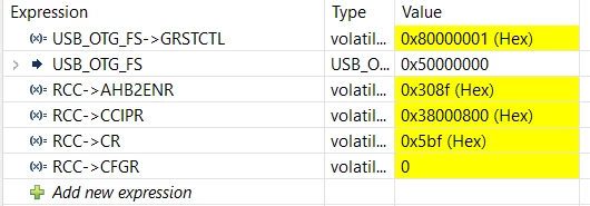

waclawek.jan
Jan 24, 2024 6:27 PM UTC
As I've said, this is usually symptom of missing 48MHz PHY clock.
> I don't know what to look for.
You are looking for differences between working and non-working state. A minimal set of registers to look at would include OTG_PCGCCTL, RCC_AHB2ENR.OTGFSEN, RCC_CCIPR.CLK48SEL, and whatever RCC registers are involved in generating the 48MHz clock itself.

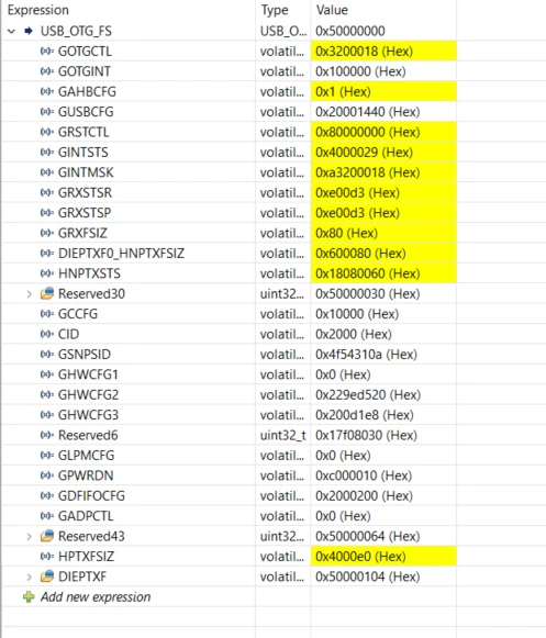

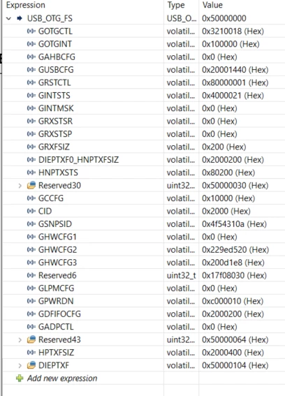

JGerb
JGerbAuthor
Jan 26, 2024 8:39 AM UTC
It cannot be missing the 48MHz clock, as I am using the MSI, and also am running the micro on the same clock (SW =0 in RCC_CFGR).
I cannot access OTG_PCGCCTL as the debugger will not show it, even when I add the expression USBx_PCGCCTL (as copied from stm32l4xx_ll_usb.c) into the window. However, this register is only referenced (as far as i can see from the code) in device mode, and I am in host mode, so I presume you meant some other register.
I've attached the expression window for the "fail" condition, but the only difference between fail and success is again USB_OTG_FS->GRSTCTL bit 0 (CSRST).
I have reviewed the clock bits before and after on both fail and success conditions, and they are both correct and unchanged. My impression is that this is more likely to be a USB variables issue inside the stack. If this is the only bug in the USB stack this time, I can live with that. On older versions of the stack some editing of the stack code was required, this version simply needs to be run a 2nd time to work. I can even do the first run after reset during my init code, and it works ok. Here's what I do after detecting a memory stick now:
