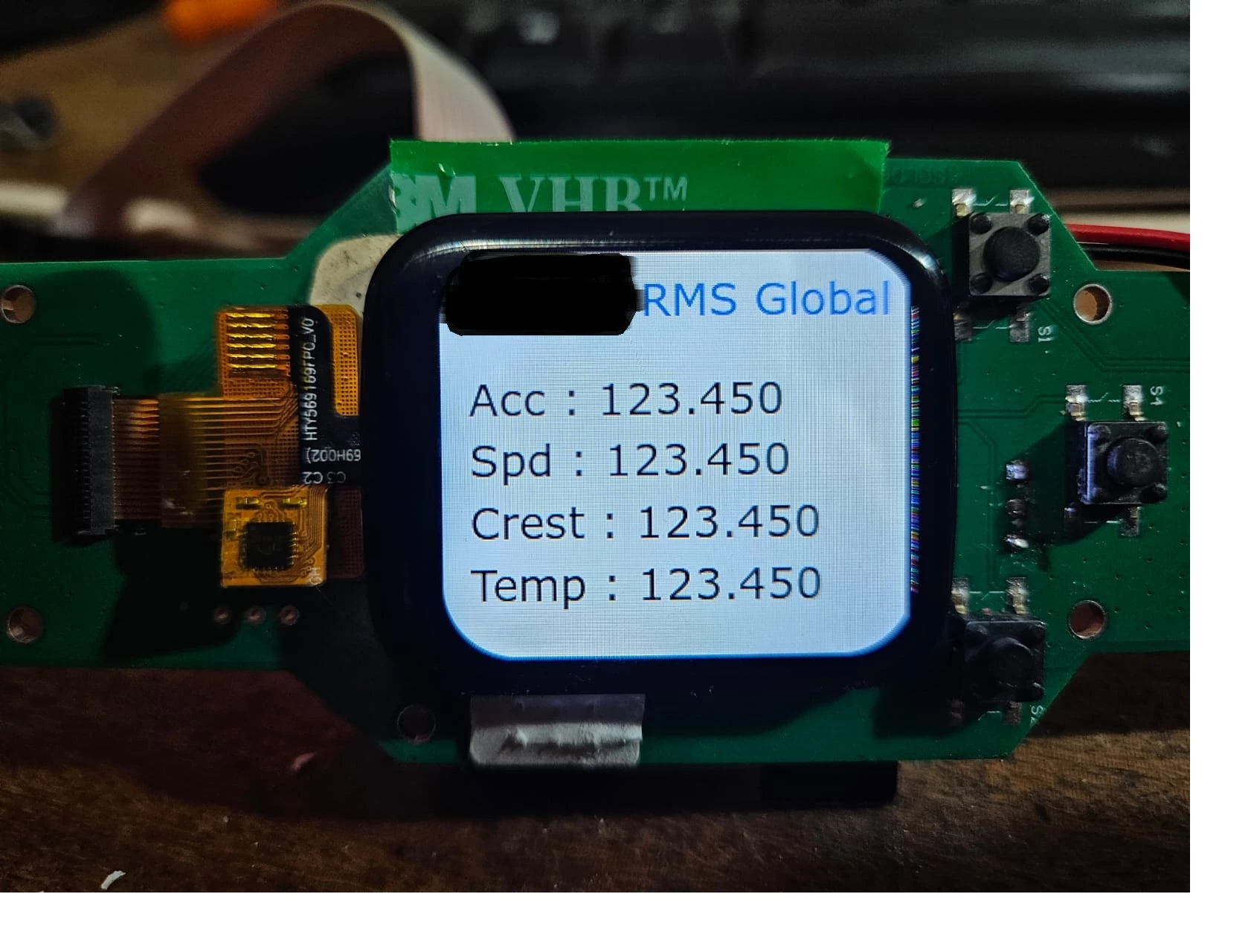

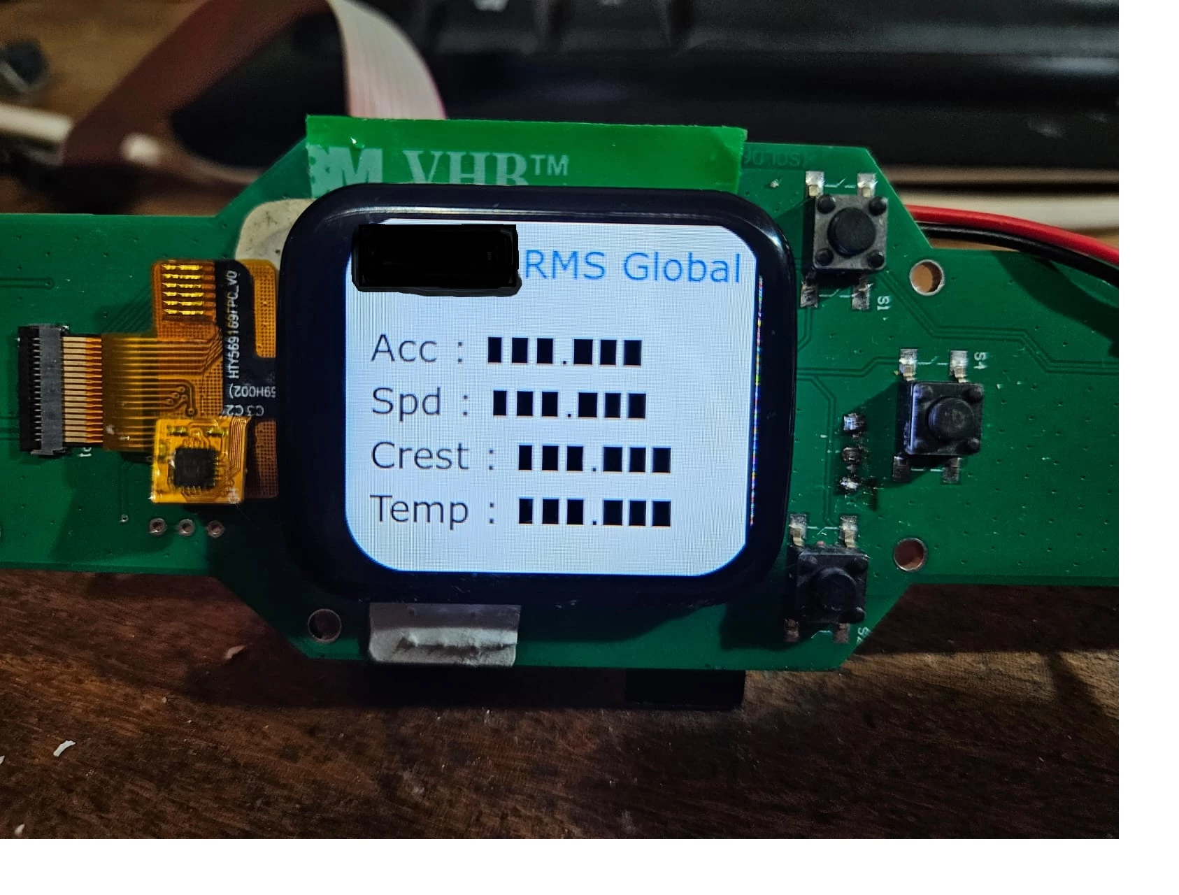

I am using a custom board with the STM32L452RET. On this board:
  • SPI1 is connected to an IIS3DWB accelerometer,
  • SPI2 is connected to a 240x280 TFT display with an ST7789 controller and TouchGFX,
  • SPI3 is used with FatFs to access an SD card, following this tutorial: https://controllerstech.com/sd-card-using-spi-in-stm32/,
  • USB CDC is used for communication.
My issue is that if I compile a file containing the FatFs functions (regardless of whether I use the SD card access functions or not), the numerical values that should be displayed on the screen appear incorrectly (see attached images). However, if I exclude the FatFs functions from compilation, the display shows the values correctly.

Hello @fmaesso
Could you try to increase the heap and stack size in your project settings?
