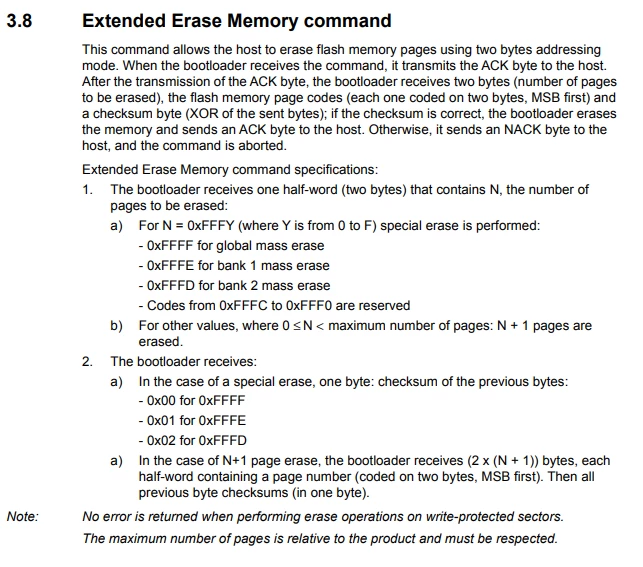

So I started monitoring the data exchange over serial between the board and the CubeProgrammer (GUI and CLI). I also had a look at the bootloader command set (application note AN3155  Rev 18) to make some sense about what's the difference between these two tools. I've also updated to STM32CubeProgrammer v2.17.0 (latest) but still no success.
I'll focus on the main differences that I found:
On the CLI side, there's not even an attempt to write any data (cmd 0x31).
On the GUI side, there's a periodic Read Chip ID exchange (cmd 0x02, presumably to check that the board is still present). There's also an operation that reads 1024 bytes starting at 0x08000000, presumably to populate the GUI after the connecting is established. There are also some read operations of size 0 bytes starting at 0x08000000. I don't think that these things are relevant for this problem anyways. However, before starting the write operation, an Extended Erase command is sent (cmd 0x44), but the data followed doesn't seem to make much sense to me:
002380: 2024-09-05 11:12:19.9858618 +0.0018714
 44 BB D»
002394: 2024-09-05 11:12:20.0000851 +0.0000259
 00 1F 00 00 00 01 00 02 00 03 00 04 00 05 00 06 ................
 00 07 00 08 00 09 00 0A 00 0B 00 0C 00 0D 00 0E ................
 00 0F 00 10 00 11 00 12 00 13 00 14 00 15 00 16 ................
 00 17 00 18 00 19 00 1A 00 1B 00 1C 00 1D 00 1E ................
 00 ...
 For reference, this is what the application note mentions:
After sending this extended erase command, the CubeProgrammer GUI starts the write operations (cmd 0x31) until completion.
Can anyone confirm if this is a bug on the CLI program? Why the need for the extended erase command? And if the extended erase command is needed, what is the data that should follow and which option to use in the CLI?
Regards,
Joao
jvieira88AuthorBest answer
Sep 5, 2024 12:46 PM UTC
OK, so I think I found a workaround, even though I believe there is a bug in the CLI program for this MCU (STM32L452).
I managed to get it working by introducing a read operation before starting to write the firmware file to flash. The GUI version of the tool does a read of 0 bytes at 0x08000000 but with the CLI this doesn't seem to be possible so I'm doing a 1 byte read, this is discarded but seems to do the trick.
Example of complete command:
"C:\Program Files\STMicroelectronics\STM32Cube\STM32CubeProgrammer\bin\STM32_Programmer_CLI.exe" -c port=COM11 -r 0x08000000 1 "test.bin" -w "C:\FW.hex" -v -s 0x08000000
Brief explanation of parameters used:
- c: Connect to COM port.
- r: Read 1 byte at 0x08000000, as explained above.
- w: Write the hex file content to flash memory.
-v: Verify
- s: Start running the application program.
Can someone from ST confirm if this bug is known? Is there a better workaround?
