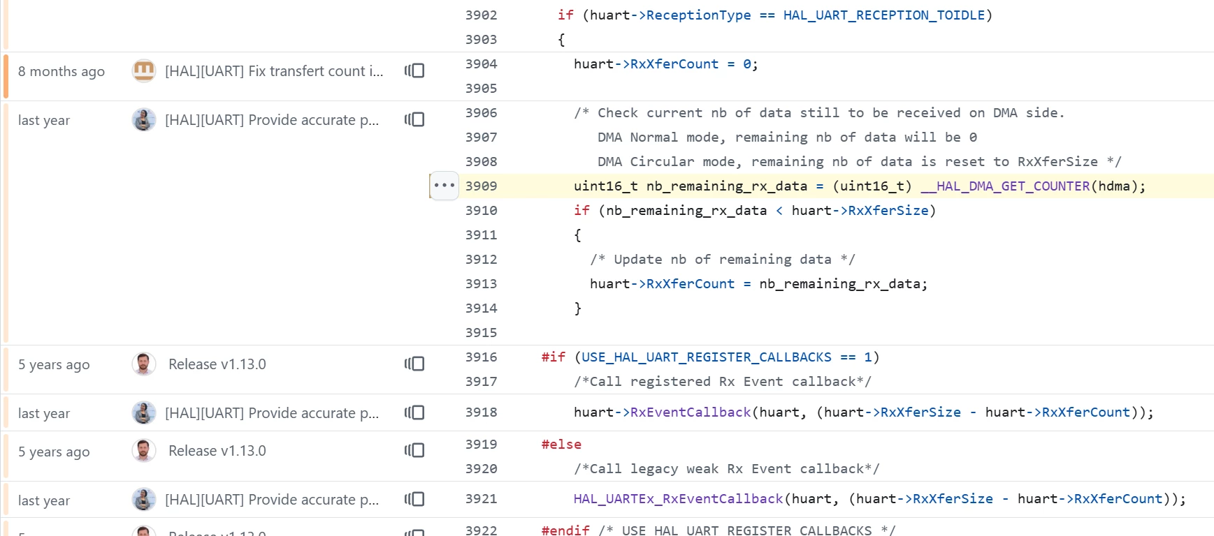

Ensure you’re on the latest version of the code as this was fixed within the past year.
Blaming stm32l4xx-hal-driver/Src/stm32l4xx_hal_uart.c at 90cd6033feb291fcaeb4221715cf848d231a762f · STMicroelectronics/stm32l4xx-hal-driver
If that’s not it, show your code, particularly the HAL_UARTEx_ReceiveToIdle_DMA call and HAL_UARTEx_RxEventCallback and how you’re getting the size values out. Seems like the number of interrupts are correct.

I’m in the latest versions of both CubeIDE and CubeMX. I’ve checked that the line pointed by TDK is indeed in my project’s version of stm32l4xx_hal_uart.c.
Kari Yamashita, unless I’m mistaken, I would expect double HT and TC interrupts only if idle happens exactly at those points in the buffer, which for the former it does happen in some iterations. However, if half or full buffer is reached while line is still busy receiving, I would expect only a single interrupt. Nevertheless, double interrupts with the same size is not a concern in my code, it’s the lack of TC interrupt.

Yeah, sure seems like a bug. Last time I tested this it worked fine, but that was over a year ago. Wonder if the “fixes” actually did the reverse.
In case it’s not obvious, the TC interrupt is clearly happening, but the Size parameter is not correctly reflected when it happens. The “double” interrupt is an IDLE plus a TC.

> except that the TC (transfer complete, or full buffer) interrupt never happens.
In the HAL source see: https://github.com/STMicroelectronics/stm32l4xx-hal-driver/blob/90cd6033feb291fcaeb4221715cf848d231a762f/Src/stm32l4xx_hal_uart.c#L2482
“ If all expected data are received, do nothing,          (DMA cplt callback will be called).”
This is conditioned “If Reception till IDLE event has been selected” && “DMA mode is enabled”.

Ok so after testing on a Nucleo-L433RC, i got the exact same values you did. But i took it further and checked the interrupt type.
So, TC does interrupt. But what the value Size that the callback passes, is not the size of the data received. I had brain fart and finally remembered that Size is actually a pointer to the DMA. How to grab the data from the DMA is the tricky part. For awhile the word Size was messing me up when i was writing a ring buffer driver. Then i finally figured out after days of debugging, that it is a pointer to the DMA. I had my driver for years so i put all that Size/Pointer behind me.

Yes, the name Size is a bit odd and it also got me initially a bit off guard. Technically, it’s a 1-based index to last written element into the buffer, and one must keep record of the previous Size value to know how many new elements have arrived since the callback was last invoked.
Hence, why with a 128-bytes buffer I expect the the Size argument to have a value of whenever Idle happens, and then 64 and 128 for HT and TC respectively.
EDIT: just to clarify that my actual application uses Size correctly, or so I hope. The simple code I provided above is to illustrate how the callback’s argument is not what I understand it should be, without actually doing anything with the receive data.
