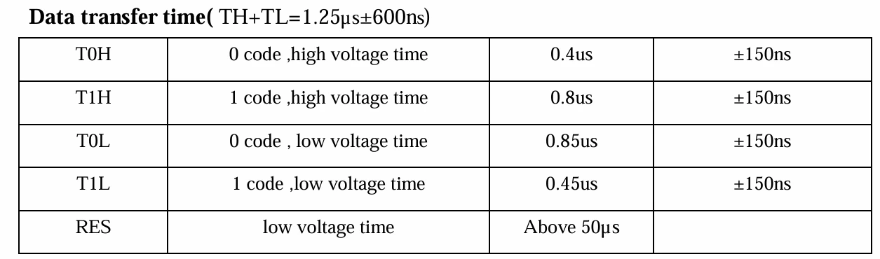

Hi, thanks for your reply. I already found it, but I thought it was an STM32F4 controller, which I believe is faster than the L4. Am I right?
May 12, 2025
I don't think speed is an issue here. Adjust the timer period based on your clock settings. It's a one line change.
The accuracy difference between HSE and HSI is not an issue for the WS2812.

As@FKaes.1 said, I also think it is related to the voltage level of DIN on the first LED.
@Andrew Neilwe don't know where @Martin42 probed the signal in his 2 plots. It can be at DOUT of the first LED, since I count 5 vertical divs for the signal.
In my experience 3V3 is not high enough, I also got wrong colors, or even wrong LEDs being lit. Once I put a level converter everything was back on track.
@Martin42in my view it is simpler to add a level converter before the first LED and see if the results are good or not.

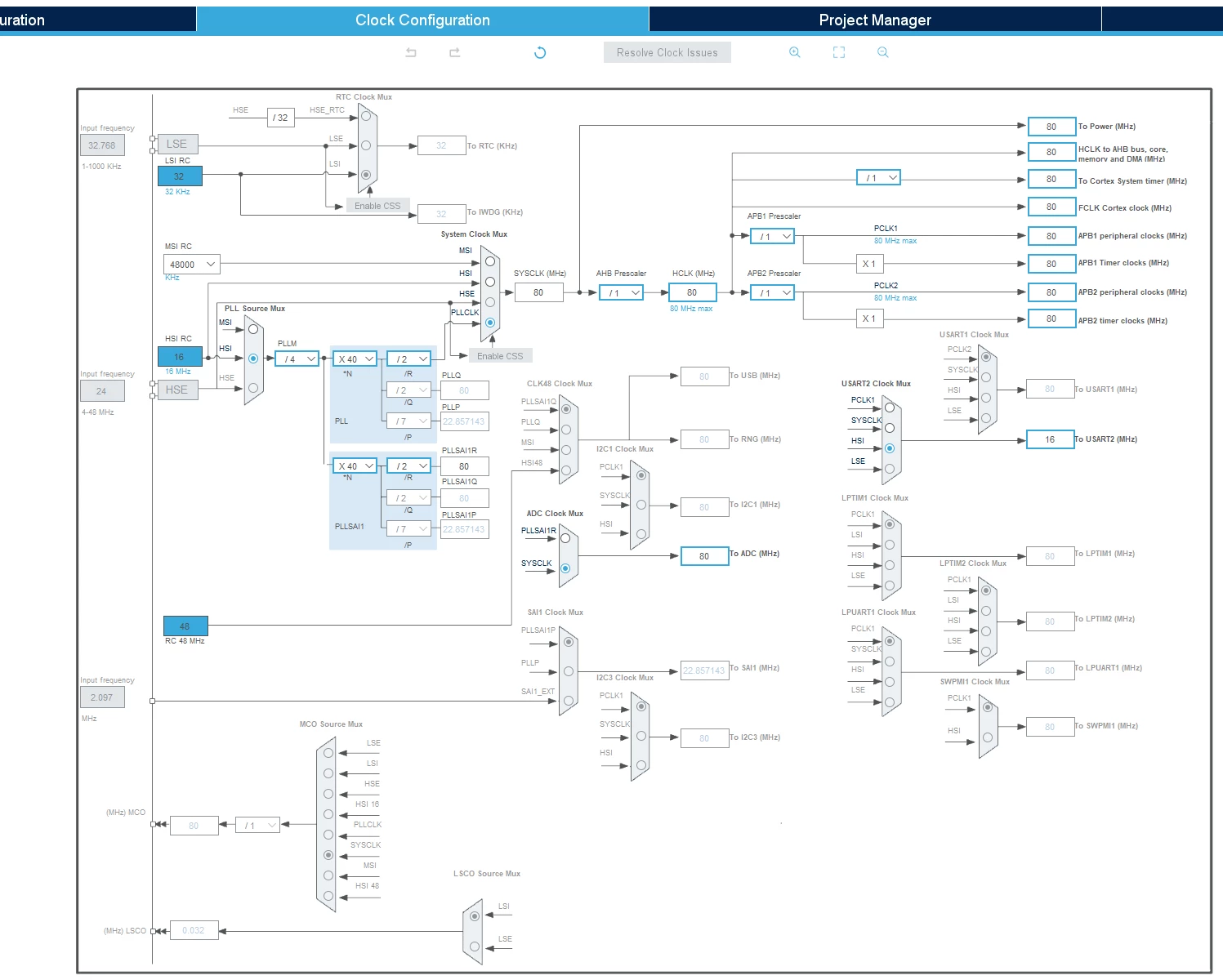

and are you using an internal RC oscillator with it?
Martin42Author
May 13, 2025
I’m now using PWM and DMA via Timer 1, Channel 2. HSI and PLL for a Sysclock of 80MHz.
