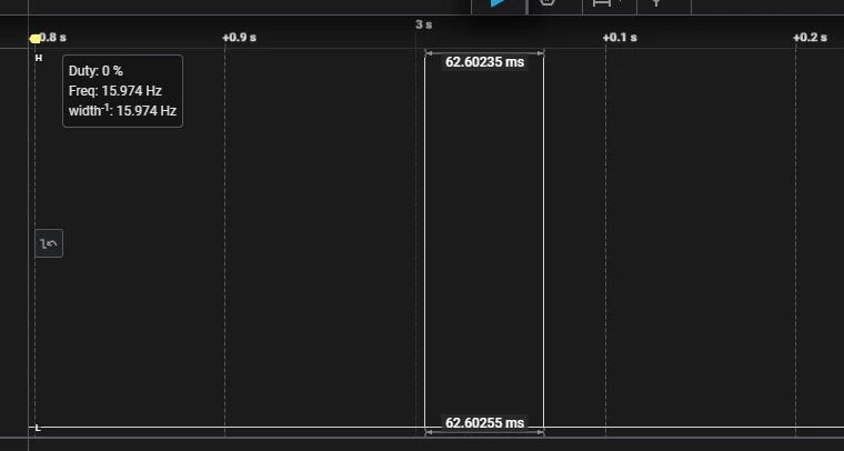

I have a NUCLEO-L432KC that I am trying to configure such that a LPTIM interrupt fires at a set time period in the future. To simplify calculations, the future time is 2048 low frequency clock ticks away (62.5 ms).
I can achieve this with relative simplicity, using the single shot mode of LPTIM1 and a CMP register value of 2048.
I am measuring the timer period by pulsing a GPIO after the timer is enabled, and inside the the Compare Match interrupt. For a prescaler value of 1x, this works as I expect (I am assuming the slight difference from 62.5 ms is due to the execution overhead of the interrupt)

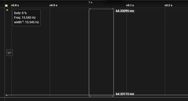

My problem is that when enabling the prescaler, simply dividing the CMP register by the prescaler ratio does not result in the interrupt occurring with the same period. For example, setting the prescaler ratio to 16x and CMP to 128.
The interrupt period has increase from 62.6 ms up to 64.3 ms. The timer resolution decreases by enabling the prescaler, but that should only account for a change of 480 uS (16 * 30.05 uS). Both tests were run on the same hardware 30 seconds apart, and the trend has been reproduced on several pieces of hardware.

I have updated the sample to be a bit more sophisticated (attached), it now rotates through the various prescalers every 500 ms and does the best linear fit I can find (CMP - 5) to get the expected interrupt period. The 1x prescaler is now almost spot on at 62.53 ms, but the 128x prescaler is still significantly off at 63.53 ms.

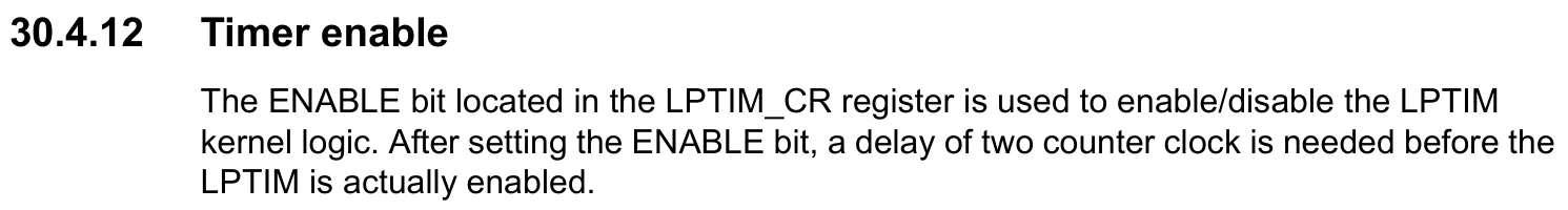

To get a period of approximately 62.5 ms for all prescalers, I needed an offset of -5 (in the second sample).
1 unit is from your suggestion.
2 units are from the timer enable delay (It seems this is 2 prescaled clock cycles, not the raw 32khz input)
2 units are still unknown. Does SNGSTRT perhaps have the same 2 cycle delay?
Once all 5 units are accounted for (which would be nice but not strictly necessary), there is still the question of why the period increases slightly as the prescaler increases. The extra 1ms at 128x prescaling is 32 raw clock ticks, which is a relatively long time.

There may be all sorts of resynchronizations in the way, both from APB interface to LPTIM kernel and vice versa. And although it sounds to me to be a design bug, this synchronization may be dependent on the prescaler. It's not clear how the prescaler is exactly applied; it may be, that it simply divides the kernel clock from RCC, before being input to the LPTIM kernel as a whole (instead of being applied only to the counter itself, which would be the sane thing to do). Btw. remarks in RM requiring the prescaler to be off for sampled clock hints, that the prescaler is applied only to the internal clock.
