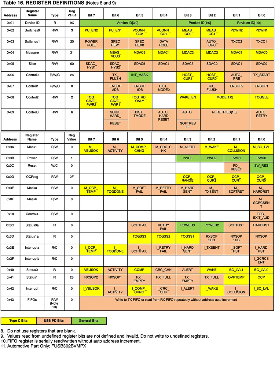

Here is register map of FUSB302B:

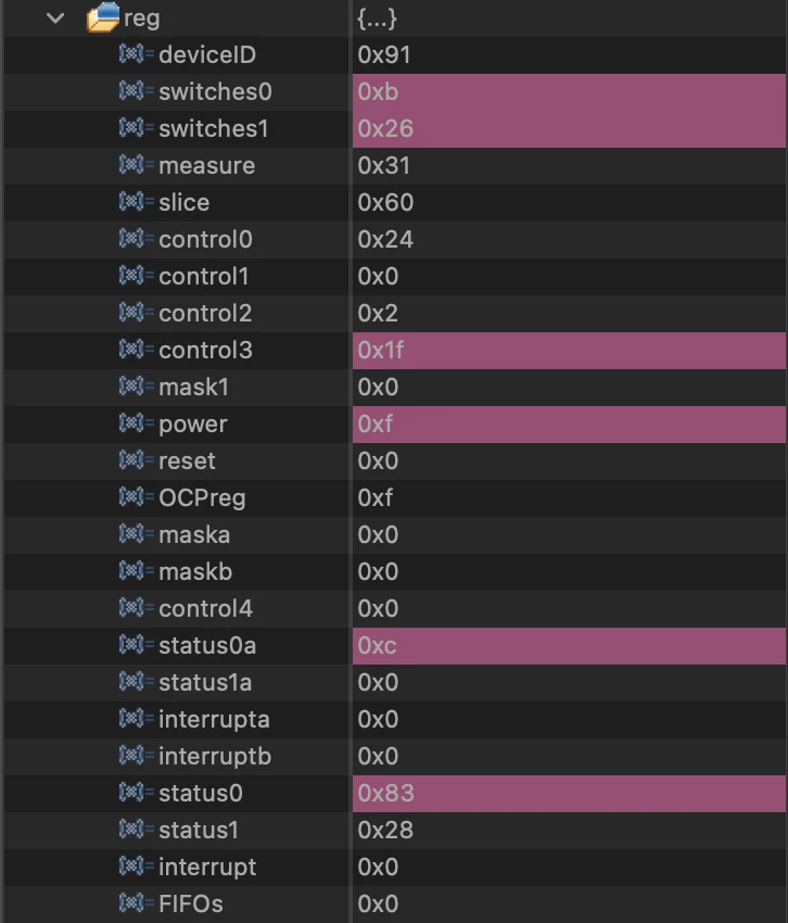

And here is my register setup after FUSB302B_start_CC_communication():
The function is doing following things:
FUSB302B_start_CC_communication:

I think after I execute FUSB302B_start_CC_communication, bit4 of status1 (RX FIFO Full) should be set because the source should transmit some data and PD controller received it, but after I execute it many times, the bit always stay 0.
The question is:
Where am I set wrong of the PD controller?
Is there anything else I need to consider when asking the PD source?
If the code have anything to improve, please fele free to give me advice!
