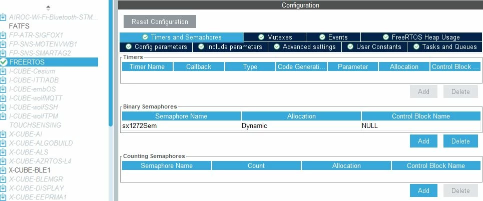

STM32L431 STM32CubeMx FreeRTOS impossible to add software timer
I would like to use software timers with FreeRTOS but the Add button is disable. The others button (add semaphore, mutexes, Events, ..) are all available...
The target is STM32L431.
Do you have any suggestion?

Hello @MLe M.1
Could you please try to put the cursor on the Add button. It should show a message that explain why this is disabled. For your case, you need to set the USE_TIMERS to Enabled on the Config parameters.
PS: This parameter is automatically set to 1 will:
  • CMSIS_RTOS_V2 is used (constraint due to current cmsis_os2.c file in FW packs)
  • xTaskGetSchedulerState equals to 0 (Disabled)
  • xTimerPendFunctionCall equals to 1 (Enabled)
  • xEventGroupSetBitFromISR equals to 1 (Enabled).
