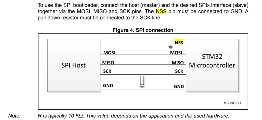

Our specific design uses TIM16_CH1 in PWM mode to control a small flyback converter. As a safety measure, we've added a pull-down to this line, so nothing bad will happen before the application firmware takes control, configures the GPIO as output and ensures a safe duty-cycle for this signal...
The issue comes when the device is powered-on for the first time: As the Flash is blank, the ROM bootloader kicks-in, which is a handy feature, but then this GPIO is set as an output, with a High-level, therefore overriding the safety pull-down resistor. This causes our flyback converter to operate out of the safe range and therefore being destroyed.
We've nailed down the issue to the bootloader configuring the SPI1 in slave mode, that for our specific GPIO (PA6) is the MISO line. As the SPI1_NSS line was left floating in the design, it the slave is Selected (SPI1_NSS -> LOW), setting SPI1_MISO (PA6) in output-high-level.

A quick check in AN2606, it is precised that NSS must be connected to the ground:
0693W00000LxGFsQAN.pngThis is said, your proposals remain valid & I'll share with our Bootloader Experts.

The bootloader is not supposed to set *any* pin to output (including AF turned to output by the associated peripheral), until the protocol associated with that pin is initialized. In case of SPI, until NSS is pulled down AND master has sent Synchronization Byte (0x5A), as per AN4286.
If it does otherwise, I consider it to be an outright - and frankly, a very unsettling - bug.
Now what the bootloaders are already known to do (although, characteristically to ST, entirely undocumented) is, that they switch pullups/pulldowns upon activity directed towards given peripheral.
So, the question for @dmanc.1900​ is: what you observe on SPI1_MISO (PA6), is a "hard" output, or a pullup? (i.e. what's the impedance of any circuit connected to it, and if decreased e.g. by using a suitable external pulldown significantly lower than the nominally 40kOhm internal pullup, does the behaviour change?)
If it is a "hard output", do you have, with the pristine mcu, any activity on the SPI pins, which can be interpreted by the target as 0x5A?
Btw. you can check bootloader's behaviour on the pins yourself, using a debugger, just put the mcu into bootloader mode, stop in debugger and read out and check the relevant SPI and GPIO registers' content.
