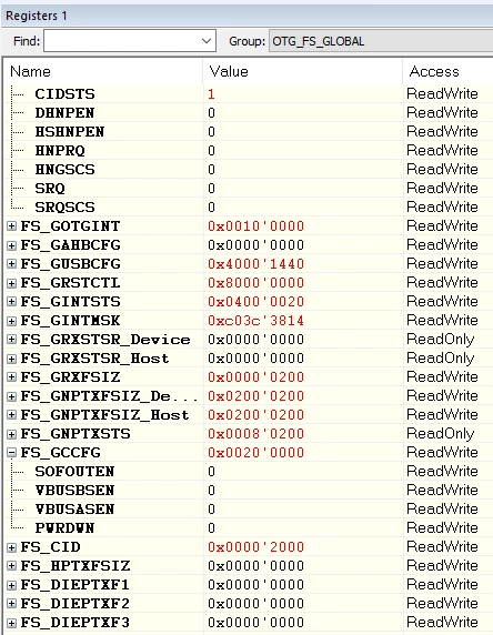

I have a custom board based around the STM32L496 that creates a USB HID device. I have two projects (built in IAR Embedded Workbench), both of which have this board and micro as their target. On the exact same board, one will enumerate USB at FS, one won't. On the one that doesn't enumerate, the OTG_FS_IRQHandler never fires. I can readily switch between projects, emulating using an STLink, and one works perfectly, while one doesn't work at all.
All of the libary code (HAL Drivers, USB Middleware, etc.) is 100% identical and taken directly from the latest version of STCube. I have verified it is identical using a WinMerge compare. My application code is virtually identical between the two projects. In fact, the "working" project is really a subset of the code in the non-working project.
To troubleshoot, I have combed through the two projects looking for differences that would explain the difference in behavior. I have isolated a subset of the code in the non-working project. This code does nothing but init the system clock, init the HAL, and init the USB. It's the first code hit when run from main(). This section of code works on the good project, but not on the bad project. I can set a breakpoint just after this init code, and the good project will have enumerated USB, while the bad project shows absolutely no USB traffic of any kind (verified on a protocol analyzer). A breakpoint in the IRQ handler in the bad project is never hit; the device state never changes from "Default" (i.e., never changes to Addressed, Configured or Suspended).
I'm getting kind of desperate here and starting to think of the possibility of weird, one-off issues. Obviously, there are differences in exactly which memory locations variables and functions are stored in; the bad project has more code that the linker is placing. But beyond memory location differences, can anyone think of anything else that might be stopping the IRQ from firing? Assume the code is indeed identical. I've included it here for the record.

Just getting back to this. Not sure how I missed it before, but for the project that is not enumerating properly, the BSVLD bit in FS_GOTGCTL is NOT getting set, indicating the "B-session is not valid". Not entirely sure what this means, as in neither case do I have VBUS sensing enabled (VBUSBSEN and VBUSASEN in FS_GCCFG are both 0).

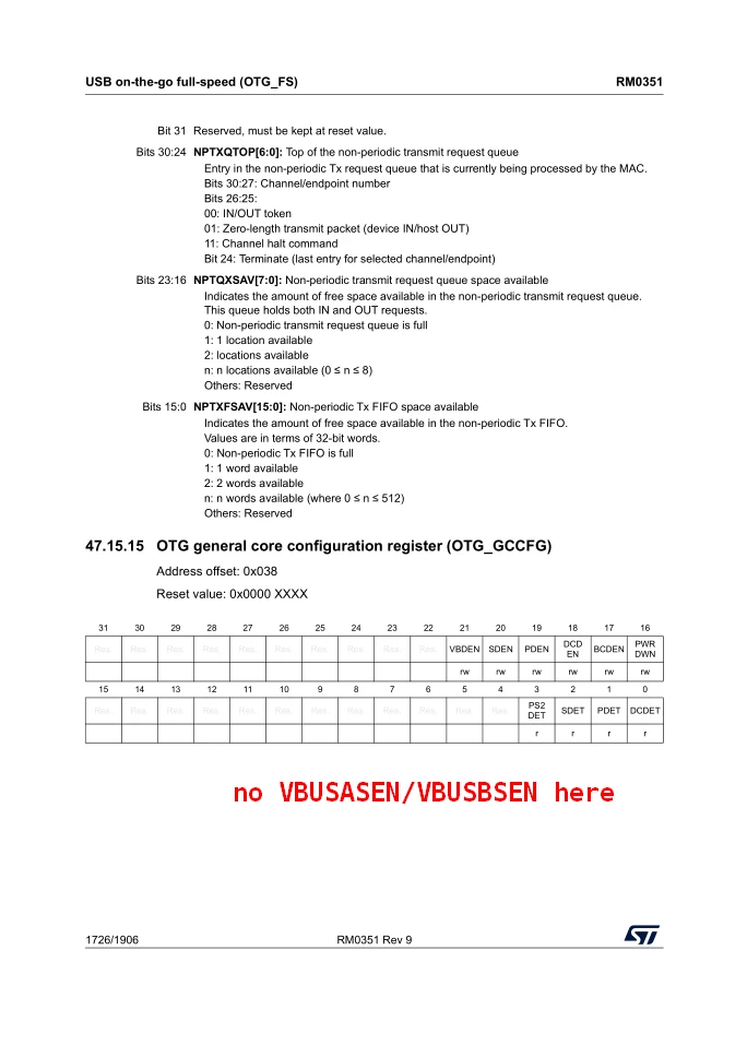

The contents of OTG_GCCFG are identical for both: the only bit that is set is the VBUS Enable Detection bit (VBDEN, bit 21).
waclawek.jan
Mar 10, 2022 2:35 PM UTC
This does not make sense.
If you don't use PA9 to detect VBUS, you should have VBDEN cleared.
OTOH, if OTG_GCCFG.PWRDWN=0, the USB can't be working in either case.
jvavra
jvavraAuthor
Mar 10, 2022 3:04 PM UTC
I apologize, I had a breakpoint inserted at the wrong position. After calling USBD_Start, the working project has ONLY PWRDWN set. The non-working project has PWRDWN AND VBUS Detection Enable set. So it looks like I need to figure out where VBDEN is getting set, and eliminate it.
waclawek.jan
Mar 10, 2022 2:44 PM UTC
Waitaminute.
How comes you have VBUSBSEN and VBUSASEN in GCCFG, on an 'L496?
jvavra
jvavraAuthor
Mar 10, 2022 2:58 PM UTC
Ah, that's because I (foolishly) trusted IAR to be giving me the correct names for the bits in the register:
