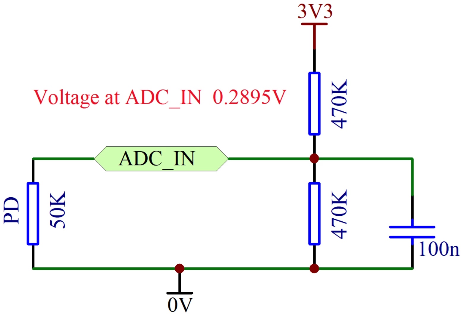

I measure a voltage on a STM32L496 using the internal ADC and found the following issue:
Setup:
The voltage is scaled down via a high-impedance voltage divider (2 x 470kOhm). To avoid distortion by sampling, the voltage divider has a 100nF capacitor. Thus, the capacitive load while sampling is low and the breakdown is 1/20000 → i.e. way lower than the ADC’s resolution. So I do not have to care about source impedance limitations as described in the datasheet (Maximum ADC RAIN).

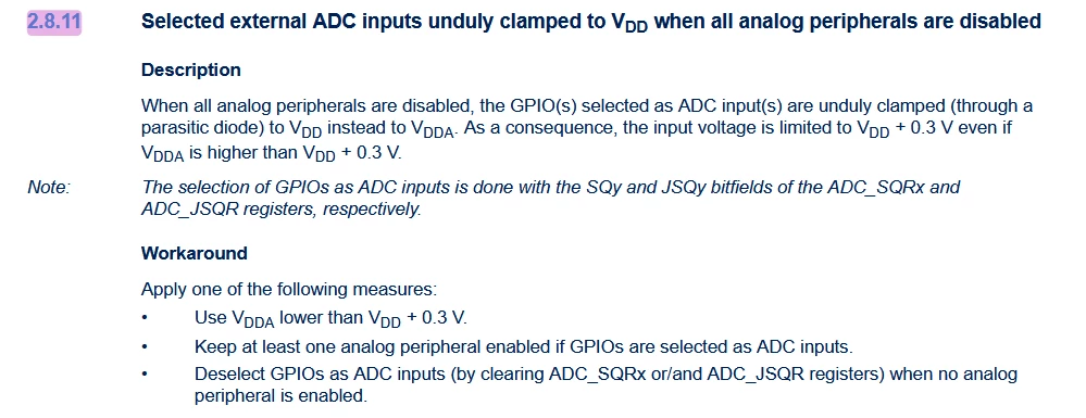

Explanation for the above effect is that with ADC_SQR1 being set the external signal is connected to the ADC. Since the ADC is off (ADC_CR.ADEN=0) its state is undefined causing the clipping on the external signal. As soon as the ADC is on everything is defined and ok.

you are right, I think this is exactly the effect that I have:
VDD=1.8V
DAC is always off
If ADC is off, voltages are limited to ~2.5V = 1.8V + 0.7V (should be 0.3V acc. to the errata but ok, some limitation)
This goes away if ADC or DAC is enabled. Problem also disappears with ADC_SQRx/JSQRx = 0. So right, my answer is exactly what you wrote in the errata. Thanks for the input and clarification.
Best regards
Markus
PS: Here is the errata excerpt, mentioned by ​@Saket_Om (ES0335 - Rev 19, p. 21)

Sep 28, 2026 6:06 PM UTC
I think the ADC input has a weak pull down resistor internally.  If the port is configured as an input it will float , very high impedance, but when software turns it to ADC alternate function the weak pull down resistor will affect your readings.
The high-impedance voltage divider (2 x 470kOhm) you explain about is very high - the weak pull down will cause a shift.
Can you use lower value resistors in the voltage divider or use an Opamp?

Using the values given and taking the ADC internal pull down as 50K I get the following:-
I’m not sure I understand the question - just to say that any port is high impedance after reset and during the switching process to Alternate Function ADC it gains the pull down.
Also it is quite possible to configure the ADC before it is connected to a port.

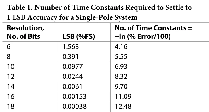

Sep 29, 2026 5:34 PM UTC
OP doesn’t say sampling frequency. Since input impedance of the ADC is in direct inverse proportion to sampling rate, than voltage observed can be any value as soon as ADC initialized and soft-start to do conversion.
100 nF only helps for very low conversion rate, about 1 sample per second.

100 nF only helps for very low conversion rate, about 1 sample per second:, ​@MasterT
  • The idea of the 100nF is to create a capactive voltage divider. Without it the voltage drops significantly during sampling since the 5pF sampling capacitor need to charge and it takes 470kOhm/2*5pF*5 = 6us for 5 tau recharging. Adding an external capacitor reduces the voltage drop during sampling to CExt/(CSample+CExt) - so with 100nF no more breakdown observable. The time constant of the 2*470kOhm and 100nF capacitors is of course huge (100ms) but the voltages are stable and do not change quickly.
  • But that is not the issue here - this breakdown is due to the not started ADC.

Sep 30, 2026 12:23 PM UTC
5 tau is not correct value, 8.32 for 12-bits and 11 if oversampling to 16-bits activated.
 But this model for time constant of charging process of the 5pF S/H capacitor is over simplified. There is such phenomenon as “charge injection”, that depends on BOOST settings,   input voltage (imply high non-linearity) and sampling rate.  It’s never documented, and likely never would.
 Best option to buffer using op-amp, L4 has some internally, for low power it’s can be switched off

Oct 13, 2026 6:33 AM UTC
​@rich.g.williams :
That is an interesting idea/hint - I checked that and found the following:
In my CubeMX-Project I set the option “Set all free pins as analog” (under Project Manager/Code generator).
The pin on which I sample the voltage is therefore always configured as analog input. If I configure it as alternate function the voltage breaks down completely to 0V. I am not sure if the pin would be configured as alternate function without the CubeMX option for analog configuration being set - but that is certainly a possibility leading to even worse effects.
After all investigation and exchange here I am sure that the issue is with the ADC being disabled while the sequencer is set already. I will contact ST directly.
Thanks for your help and ideas :)
Oct 13, 2026 6:43 AM UTC
To anyone who experiences the same effect:
Make sure that the ADC is enabled before you configure the sequencer.
This means:
  • Register level: Set ADCx->CR->ADEN to 1 before writing ADCx->SQRx to anything but 0
  • CubeL4: Call the following functions:
    • HAL_ADC_Init, (optional: HAL_ADCEx_Calibration_Start), ADC_Enable, HAL_ADC_ConfigChannel
Best regards
Markus

Oct 13, 2026 2:39 PM UTC
Hello ​@MarkusVogel
Did you try the workarounds described in the point 2.8.11 in the errata sheet.

MarkusVogelAuthorBest answer
Oct 14, 2026 10:56 AM UTC
Hi ​@Saket_Om ,
VDD=1.8V
DAC is always off
