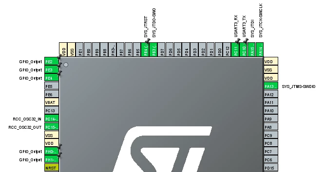

I am using a sTM32L430 with a JTAG access throgh ST LINK V2 and STM32CubeIDE. The project has a few GPIO to debug and an USART to generate interrupts:
To try to undersand my problem I build a small project with STM32CubeMX to have code genrated by STM and not by me.
I added a few code to remove data from the USART BX buffer and to toggle debug pins.

I load and run the program. If an interrupt occurs during debugging I have the following issue:
Program stops (led do not toggles) and current consumption increases from 2mA to 14mA. If I click on the suspend button I have the following message:
Break at address "0x1fff3f36" with no debug information available, or outside of program code.
This address is inside the System memory.
When I have interrupts while not in debugging mode there is no issue at all.
Do you have any suggestion for this issue which prevents me of debugging capabilities?

mich35Best answer
Nov 16, 2023 1:13 PM UTC
It seems to be linked to a solder issue around the LSE quartz.
The microC reacts differently when started from JTAG or from power on...

AScha.3
Nov 13, 2023 1:57 PM UTC
boot0 pin (PH3 ?) needs pulldown. or gnd . otherwise jumping to system bootloader mode...
mich35Author
Nov 13, 2023 2:58 PM UTC
PH3 has a pull-down
