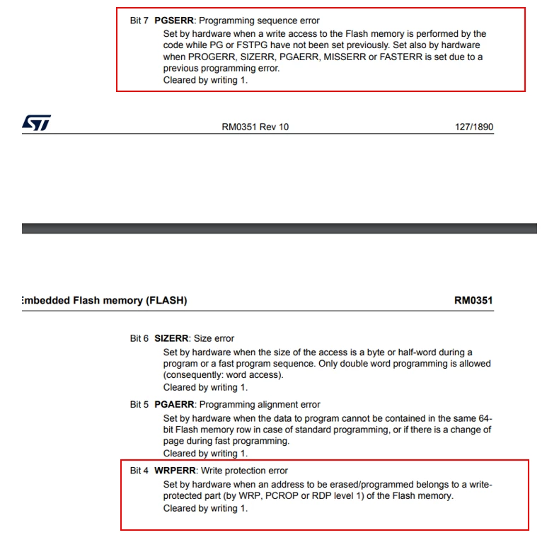

I have written a firmware which write some meta data in STM32L4 internal flash memory. But sometimes it happens that code gets stuck in a loop while erasing the flash memory.

Above is the code snippet, where I checked FLASH_UNLOCK is happening perfectly. And also Bank and page number are also correct. But Erasing the flash memory is giving error HAL_FLASH_ERROR_PGS and HAL_FLASH_ERROR_WRP.
To understand the reason, I uploaded the code again, and it gets stuck here (2 times I checked it). But when I started debugging line by line, then it worked perfectly. After erasing, write also happen correctly.
Has anyone encountered a similar issue or have insight, how can I recreate this issue and why erasing the internal flash is giving this issue and how can I resolve it?

After you unlock the flash but before you do anything with it, check for and clear all error flags. The debugger does stuff that can cause them to be set.

Thanks for your reply. But this issue I faced in the working board and gets stuck in the infinite loop (as you can see in the code snippet) To debug this I have to put a debugger to know the reason, and code got stuck in same place.
I can assume that flag might be set getting because of the debugger, but can you suggest what can be the reason flags getting set without debugger because I have got this in multiple boards.
I debug 3 times without breakpoint and code used to hand there but when I started debugging step by step from that time it started working, can you suggest what can be the reason for it?

Probably a software bug. Perhaps you are not completing a flash page write. Perhaps only writing a partial flash page. The issue is likely with the programming, not the erase code you've posted.

To resolve issues related to STM32L4 flash erase failures, specifically HAL_FLASH_ERROR_PGS (Programming Sequence error) and HAL_FLASH_ERROR_WRP (Write Protection error), it is crucial to ensure that flash memory operations are executed correctly and all necessary precautions are taken. Follow these steps:
  • Unlock the Flash: use HAL_FLASH_Unlock() to unlock the flash memory, allowing write and erase operations.
  • Clear Flash Error Flags: use the __HAL_FLASH_CLEAR_FLAG macro to clear all possible flash error flags before starting the erase operation.
  • Erase the Flash Pages: call the HAL_FLASHEx_Erase function to erase the specified pages.
  • Lock the Flash: after the erase operation, lock the flash memory using HAL_FLASH_Lock() to prevent accidental writes.
