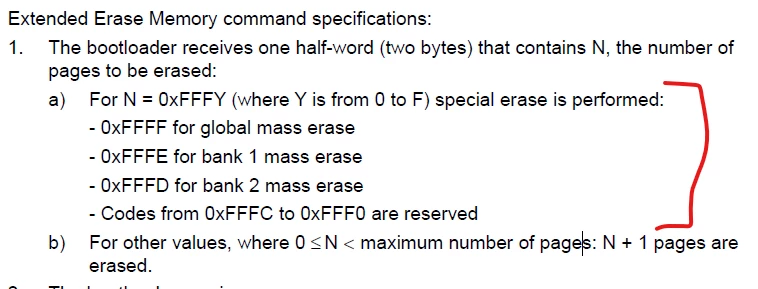

the extended erase command is supported, but only for the single page erase, i.e. it is not possible to perform the 'special erase' described in the application note AN3155:
Here there are the byte sequences:
  1.  handshake and get info:
    tx: 7f
    rx: 79
    tx: 00 ff
    rx: 79 0b 31 00 01 02 11 21 31 44 63 73 82 92 79
  2. global mass erase
    tx: 44 bb
    rx: 79
    tx: ff ff 00
    rx: 1f
  3. bank 1 mass erase
    tx: 44 bb
    rx: 79
    tx: ff fe 01
    rx: 1f
  4. single page erase
    tx: 44 bb
    rx: 79
    tx: 00 00 00 00 00
    rx: 79
    tx: 7f
    rx: 79
    tx: 00 ff
    tx: 44 bb
    rx: 79
    tx: ff ff 00
    rx: 1f
    tx: 44 bb
    rx: 79
    tx: ff fe 01
    rx: 1f
    tx: 44 bb
    rx: 79
    tx: 00 00 00 00 00
    rx: 79
