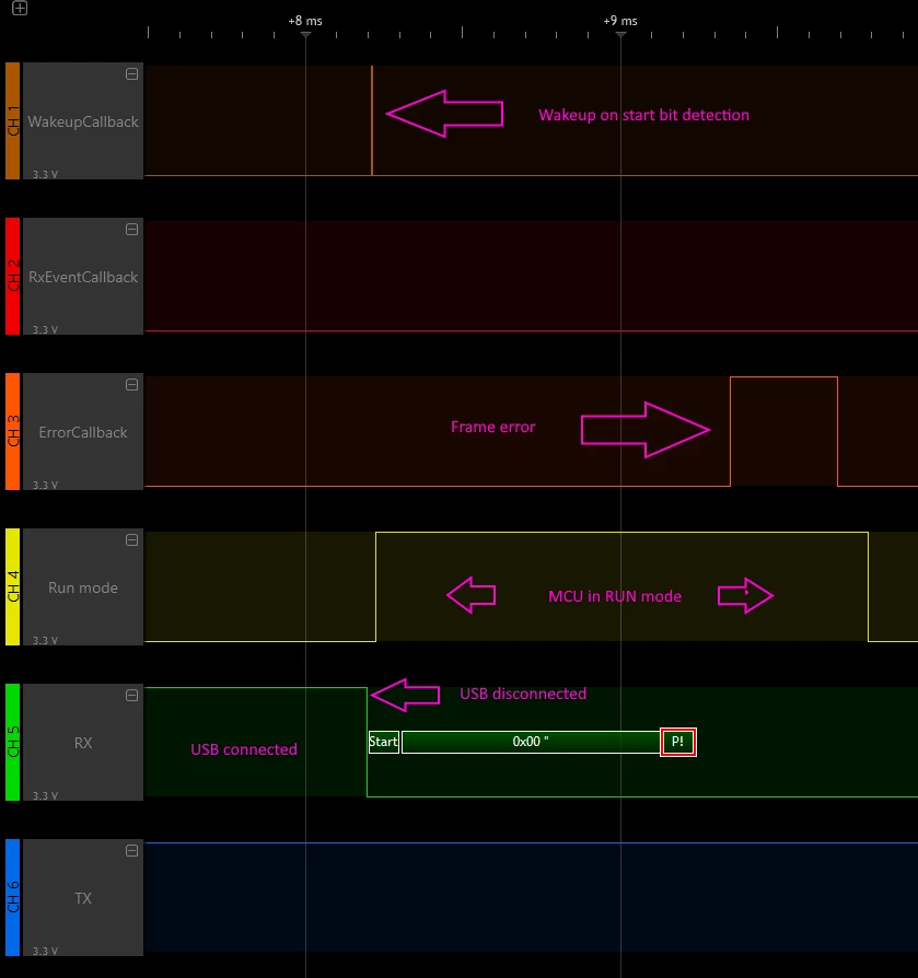

I am using a custom board integrating a STM32L071kzt6 MCU and have an issue to wakeup the MCU with uart start bit detection if the MCU uart rx line was no more pullup by the device with which the MCU communicates (A FT230XS USB to RX bridge).
It is the case when the USB which powered the FT230XS chip is disconnected.
When the USB is then reconnected, the FT230XS chip re pull-up the MCU uart rx line as expected, but communication is no more possible.
If the UART RX pin is internally pulled up, the problem disappear as the RX line does't get low when USB is disconnected, but I don't know if it is a relevant solution

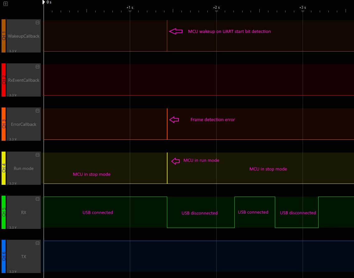

In fact the MCU wakeup with UART start bit detection when USB is disconnected the first time, then a frame error appears, and then the MCU re-enter stop mode.
But it is not possible to wakeup again the MCU with UART start bit detection.
(It is still possible with other way as EXTI, or I2C on match address detection for exemple)
There is no problem if the MCU is in RUN mode, so it is really a problem with how I handle STOP mode
Here are the main code :

And below captures show when callback functions are called and MCU UART RX and TX line state:

YohannDrcAuthor
Jul 12, 2024 6:28 AM UTC
I read the STM32L07xxx/L08xxx device errata documentation.
There was indeed issues with wakeup from stop mode with UART on MCU revision A and B.
However the issue disappeared on current revision (1, P, Q, Z) of the MCU. The MCU I used is rev Z, so there is normally no problem with that.
