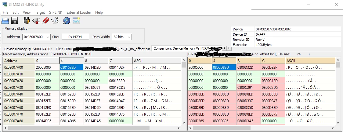

The bootloader shifts this by adding the offset to any word which falls within the flash range, i.e. between 0x08000000 and 0x0802FFFF. So the bin file looks something like this after (left) and before (right) the shift:
You can see that, for example, 0x0800D89D has been shifted to 0x0801529D by adding on the offset of 0x7A00. What you end up with is identical to the binary compiled with the flash offset as in 1).
The downside to method 1) is that you have to make sure you have compiled the firmware with the correct offset before sending it with to the bootloader. This is not great if there are different sized versions of the bootloader, or multiple possible app slots.
The problem with 2) is that it is possible the the shifting algorithm may not work for every bin file. For example, if you had a constant string (stored in flash) which happened to be stored in memory such that it looked like an address which should be shifted. Your binary data would then get corrupted, and break the application.
