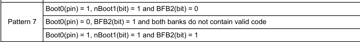

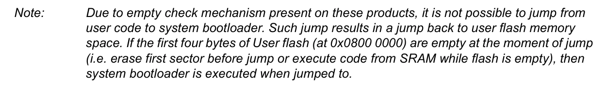

Jump on MCUs with detection firmware in flash not work or better say work , but default jump back to app if is detected in flash. One way is erase first memory sector before jump.
Second maybe as AN2606 pattern say
try BFB2 0

Hi, I'm facing the same issue on my L072.
Have you finally succeeded to get into DFU ? If so, can you tell me how ?
Visitor II
Dec 13, 2024 3:29 PM UTC
This is my code, it worked fine on my L072.
It is imporant to erase the first 4 bytes of user flash, you can find in AN2606 Rev 64 (p.69).
I was helped by many posts, thanks all.
