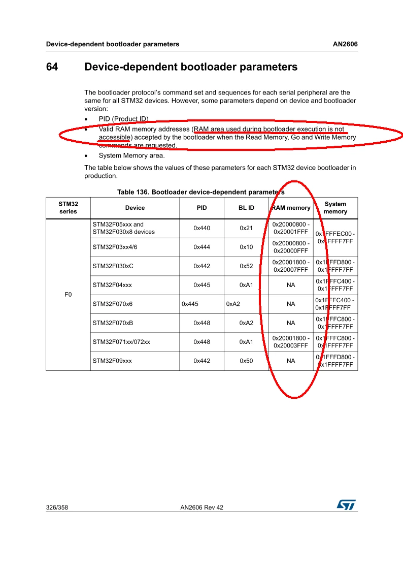

STM32L05x - How can I read SRAM via bootloader(system) ?
I'm trying STM32L05x embedded bootloader - Read Memory command via UART.
I can read flash memory (e.g. address start by 0x0800_0000), but when I try to read SRAM ( start by 0x2000_0000) , it always return NACK.
Is it not possible to read SRAM via bootloader?

You could perhaps write code residing higher in RAM, and execute that to perform different modes of access, external memory or whatever.
