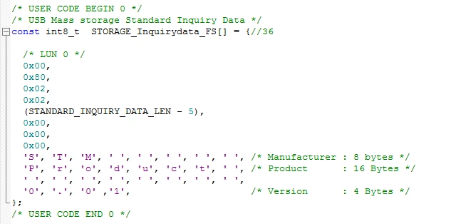

Now I have new project, I would like show data from memory on microcontroller on my PC. I created project in STMCubeMX then build and load on flash from KEIL, Connect my NUCLEO 64 board on PC over USB and in my computer show USB Flash drive, but I cannot open this because is in RAW format. I don't know how to view my data on MCU.

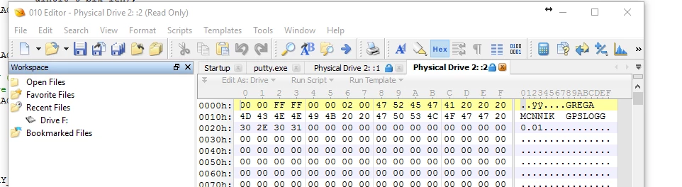

I ran an example, which was generated in STM32Cube. I connected the USB with the PA11 and PA12. I set the jumper on E5V and the device showed on my PC (Raw file system). I can see the memory map with HEX Editor.
> I wish to access my data  on the flash. How can I do it?
You may directly read the drive sectors from the MSC device to your PC, like your 010 editor / drive editor mode.
For Linux application, just open() the drive device, like this post,
http://stackoverflow.com/questions/7289453/reading-hard-disk-sectors-in-c-on-linux
For Windows, SPTI (SCSI Pass Through Interface) is available.
Send READ10 SCSI command over SPTI.
https://msdn.microsoft.com/en-us/library/ff560519%28VS.85%29.aspx
https://github.com/Microsoft/Windows-driver-samples/tree/master/storage/tools/spti
