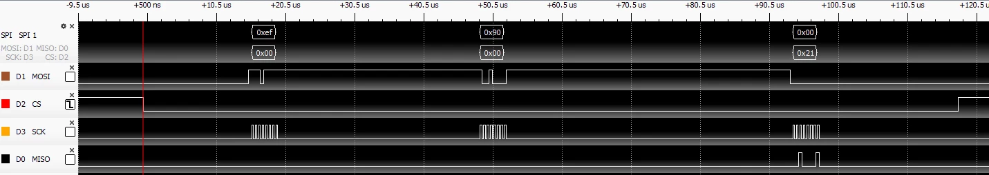

I'm trying to set-up a simple SPI communication between a STM32L0 Nucleo board and a slave device.
I made the SPI and PINs configuration using the CubeMX tool and seems to work pretty well but the SPI has some problem:
I'm trying to read a register that contains the value 0x21. I can see on my logic analyzer that the byte running on the bus contains the correct value, but the HAL_SPI_Receive function returns 0x20 as received value (as you can see in the attached image).
I've tryed to manually check the SPI initialization but it seems correct...

The reading function I'm using is HAL_SPI_Transmit(&hspi2, dataBuffer, dataLength, 1000); where dataBuffer is a uint8_t array and dataLength is set to 1.
The NSS is manually handled and it works correctly (checked with the oscilloscope).
Any ideas?
