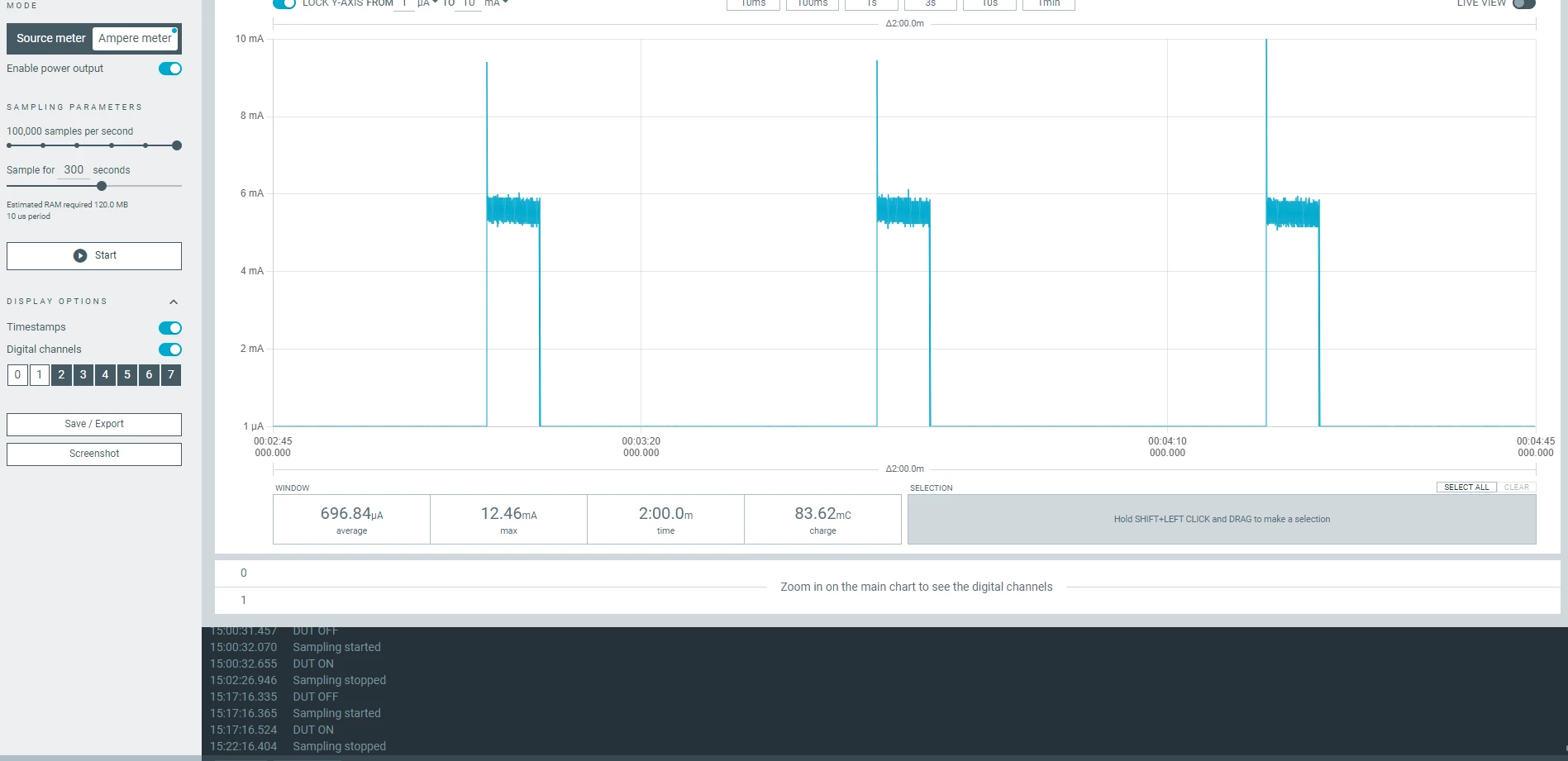

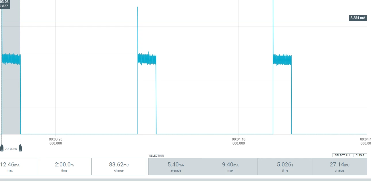

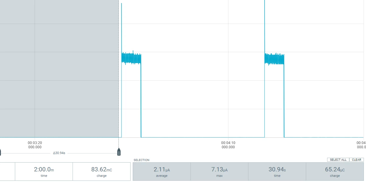

I have run the Power Profiler for 5 minutes and the results are as following:
Sleep current consumption:
Active mode power consumption:
I can see that the power consumption in Standby mode is about 2uA. The power when the device wakes up is about 5mA.

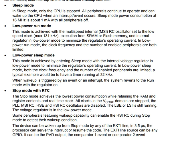

Additionally, I was thinking that instead of running the CPU in normal mode during the awake time, perhaps I can run it in some other mode?
Can I use Sleep mode (not standby) or low-power run mode and still use SPI/I2C interfaces?
I am happy with the standby current consumption but I would like to reduce the awake current consumption (5mA)
