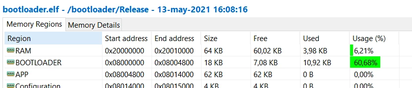

Javier1
Principal
Jun 7, 2021 7:45 AM UTC
My jumptoAPP function from the bootlodaer looks like this;
void jumpToApp(const uint32_t address) {
	const JumpStruct *vector_p = (JumpStruct*) address;
	deinitEverything();
	/* let's do The Jump! */
	/* Jump, used asm to avoid stack optimization */
	asm("msr msp, %0; bx %1;" : : "r"(vector_p->stack_addr), "r"(vector_p->func_p));
void deinitEverything() {
	//-- reset peripherals to guarantee flawless start of user application
	//	HAL_GPIO_DeInit(LED_GPIO_Port, LED_Pin);
	HAL_GPIO_DeInit(CAN1_TX_BOOTLOADER_GPIO_Port, CAN1_TX_BOOTLOADER_Pin);
	HAL_GPIO_DeInit(CAN1_RX_BOOTLOADER_GPIO_Port, CAN1_RX_BOOTLOADER_Pin);
	HAL_CAN_DeInit(_hcan);
	HAL_RCC_DeInit();
	HAL_DeInit();
	SysTick->CTRL = 0;
	SysTick->LOAD = 0;
	SysTick->VAL = 0;
hit me up in https://www.linkedin.com/in/javiermuñoz/
Javier1
Principal
Jun 7, 2021 7:46 AM UTC
My enter bootloader function is just a NVIC_SystemReset()
