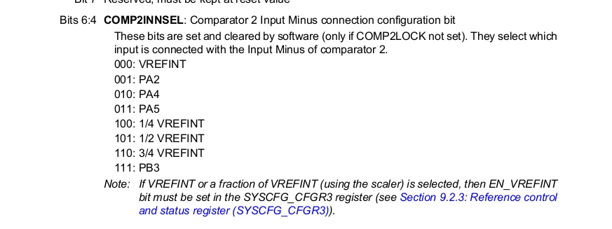

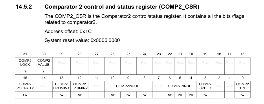

I was having some issues with getting comparator 2 working on my STM32L011K4 (Category 1 Device). I was trying tocompare a voltage on PA7 with 1/2 VREFINT. It wasn't working the way I intended it to. I dug further into the documents and found that the Low Level Drivers (FW_L0_V1.0) provided by ST is missing a bit field that is important to getting comparator 2 working with scalar VREFINT.

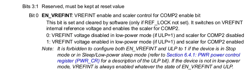

- In order to get scalar VREFINT working on comparator 2, ST states the following:

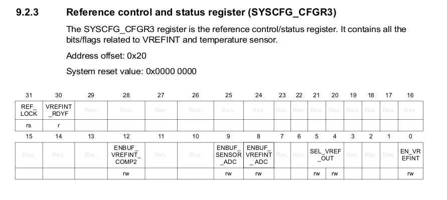

- Moving to SYSCFG_CFGR3, it is clear in the reference manual that you have toset EN_VREFINT to get scalar voltage for COMP2:
- Digging into the drivers stm32l011xx.h, the bit-field EN_VREFINT is missing which in turnstm32l0xx_ll_system.h doesn't have a function to set this bit high:
/***************** Bit definition for SYSCFG_CFGR3 register ****************/
#define SYSCFG_CFGR3_VREF_OUT_Pos (4U)
#define SYSCFG_CFGR3_VREF_OUT_Msk (0x3U << SYSCFG_CFGR3_VREF_OUT_Pos) /*!< 0x00000030 */
#define SYSCFG_CFGR3_VREF_OUT SYSCFG_CFGR3_VREF_OUT_Msk /*!< Verf_ADC connection bit */
#define SYSCFG_CFGR3_VREF_OUT_0 (0x1U << SYSCFG_CFGR3_VREF_OUT_Pos) /*!< 0x00000010 */
#define SYSCFG_CFGR3_VREF_OUT_1 (0x2U << SYSCFG_CFGR3_VREF_OUT_Pos) /*!< 0x00000020 */
#define SYSCFG_CFGR3_ENBUF_VREFINT_ADC_Pos (8U)
#define SYSCFG_CFGR3_ENBUF_VREFINT_ADC_Msk (0x1U << SYSCFG_CFGR3_ENBUF_VREFINT_ADC_Pos) /*!< 0x00000100 */
#define SYSCFG_CFGR3_ENBUF_VREFINT_ADC SYSCFG_CFGR3_ENBUF_VREFINT_ADC_Msk /*!< VREFINT reference for ADC enable bit */
#define SYSCFG_CFGR3_ENBUF_SENSOR_ADC_Pos (9U)
#define SYSCFG_CFGR3_ENBUF_SENSOR_ADC_Msk (0x1U << SYSCFG_CFGR3_ENBUF_SENSOR_ADC_Pos) /*!< 0x00000200 */
#define SYSCFG_CFGR3_ENBUF_SENSOR_ADC SYSCFG_CFGR3_ENBUF_SENSOR_ADC_Msk /*!< Sensor reference for ADC enable bit */
#define SYSCFG_CFGR3_ENBUFLP_VREFINT_COMP_Pos (12U)
#define SYSCFG_CFGR3_ENBUFLP_VREFINT_COMP_Msk (0x1U << SYSCFG_CFGR3_ENBUFLP_VREFINT_COMP_Pos) /*!< 0x00001000 */
#define SYSCFG_CFGR3_ENBUFLP_VREFINT_COMP SYSCFG_CFGR3_ENBUFLP_VREFINT_COMP_Msk /*!< VREFINT reference for comparator 2 enable bit */
#define SYSCFG_CFGR3_VREFINT_RDYF_Pos (30U)
#define SYSCFG_CFGR3_VREFINT_RDYF_Msk (0x1U << SYSCFG_CFGR3_VREFINT_RDYF_Pos) /*!< 0x40000000 */
#define SYSCFG_CFGR3_VREFINT_RDYF SYSCFG_CFGR3_VREFINT_RDYF_Msk /*!< VREFINT ready flag */
#define SYSCFG_CFGR3_REF_LOCK_Pos (31U)
#define SYSCFG_CFGR3_REF_LOCK_Msk (0x1U << SYSCFG_CFGR3_REF_LOCK_Pos) /*!< 0x80000000 */
#define SYSCFG_CFGR3_REF_LOCK SYSCFG_CFGR3_REF_LOCK_Msk /*!< CFGR3 lock bit */
/* Legacy defines */
#define SYSCFG_CFGR3_ENBUF_BGAP_ADC SYSCFG_CFGR3_ENBUF_VREFINT_ADC
#define SYSCFG_CFGR3_ENBUFLP_BGAP_COMP SYSCFG_CFGR3_ENBUFLP_VREFINT_COMP
#define SYSCFG_VREFINT_ADC_RDYF SYSCFG_CFGR3_VREFINT_RDYF
#define SYSCFG_CFGR3_SENSOR_ADC_RDYF SYSCFG_CFGR3_VREFINT_RDYF
#define SYSCFG_CFGR3_VREFINT_ADC_RDYF SYSCFG_CFGR3_VREFINT_RDYF
#define SYSCFG_CFGR3_VREFINT_COMP_RDYF SYSCFG_CFGR3_VREFINT_RDYF�?�?�?�?�?�?�?�?�?�?�?�?�?�?�?�?�?�?�?�?�?�?�?�?�?�?�?�?�?�?�?�?�?�?�?�?�?�?�?�?�?�?�?�?�?�?�?�?�?�?�?�?�?�?�?�?�?�?�?�?�?�?�?�?�?�?�?�?�?�?�?�?�?�?�?�?�?�?�?�?�?�?�?�?�?�?�?�?�?�?�?�?�?�?�?�?�?�?�?�?�?�?�?�?�?�?�?�?�?�?�?�?�?�?�?�?�?�?�?�?�?�?�?�?�?�?�?�?�?�?�?�?�?�?�?�?�?�?�?�?�?�?�?�?�?�?�?�?�?�?�?�?�?�?�?�?�?�?�?�?�?�?�?�?�?�?�?�?�?�?�?�?�?�?�?�?�?�?�?�?
- My current workaround for testing purpose is to modify a function in stm32l0xx_ll_system.h:
* @brief Buffer used to generate VREFINT reference for comparator enable
* @rmtoll SYSCFG_CFGR3 ENBUF_VREFINT_COMP LL_SYSCFG_VREFINT_EnableCOMP
* @retval None
__STATIC_INLINE void LL_SYSCFG_VREFINT_EnableCOMP(void)
SET_BIT(SYSCFG->CFGR3, SYSCFG_CFGR3_ENBUFLP_VREFINT_COMP);
SET_BIT(SYSCFG->CFGR3, 0x1); // Setting EN_VREFINT to '1'
This workaround seems to have worked for me. I hope this is the issue and if so, gets fixed on the next version of the firmware.
