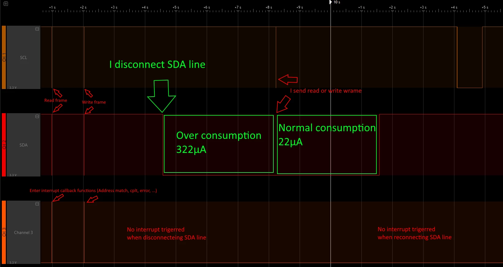

I get stuck with an issue and can't figure what to do.
I implemented on a STM32l071 a I2C slave and using DMA with circular buffer, I am using HAL with CubeMX generated code.
The microcontroller is by default in stop mode, so when something communicates with the microcontroller with I2C, the microcontroller wakes up by I2c address match, then do what it has to do, then return in stop mode.
All that I have implemented seems to work well.
The custom board we are using consume around 22µA when the microcontroller is in stop mode.
The problem is:
When I disconnect only the SDA line before SCL line, the board consume arround 321µA .
(I can then disconnect and reconnect all lines it doesn't change the result).
Then If a send a read or write I2C frame with the master with SCL connected, (SDA connected or not), the board consumption go back to normal at 22µA.
Before entering stop mode, I clear all power flag and I2c flag just in case.
I also activate an output pin in order to see if some I2C callback function are called but it does'nt semm to be the case.
I attach the code and capture of SCL, SDA and output pin
Thanks in advance for your help

Dec 20, 2024 1:40 PM UTC
When SDA drops with SCL high, that is a start condition and the bus is no longer idle. It makes sense that current consumption would increase as it's now waiting for something to happen.
You should pull up SDA/SCL on the STM32 side of the disconnection. That way they stay high and the chip doesn't even know it's disconnected.
