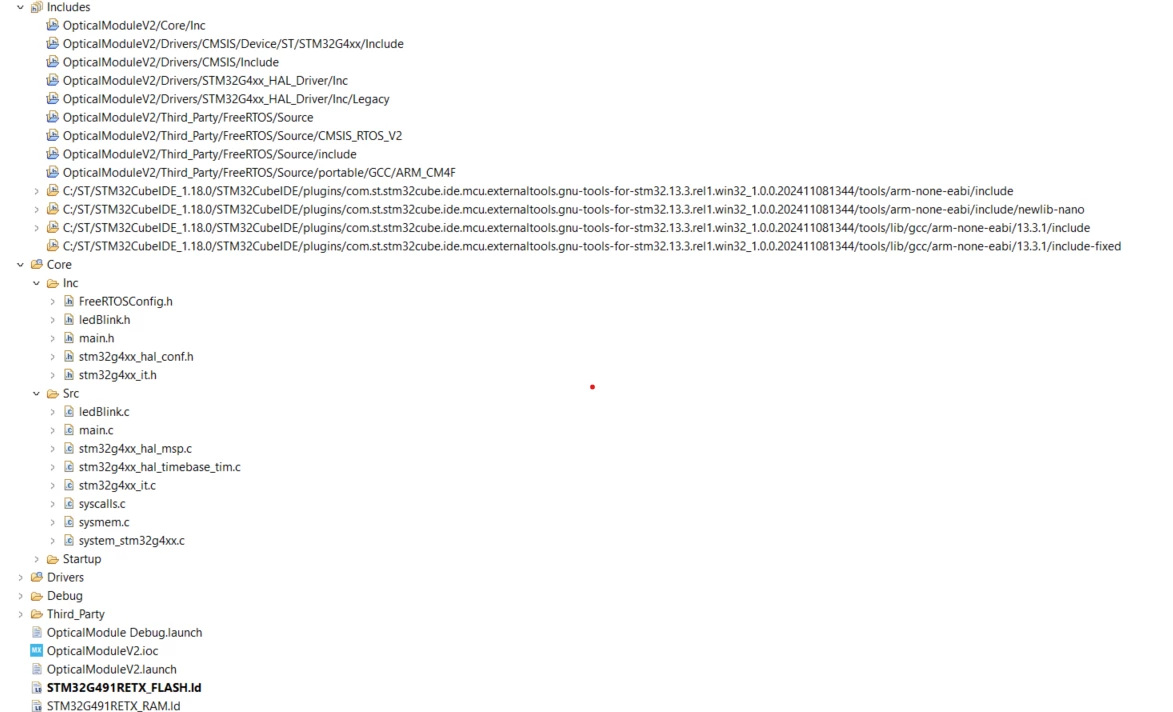

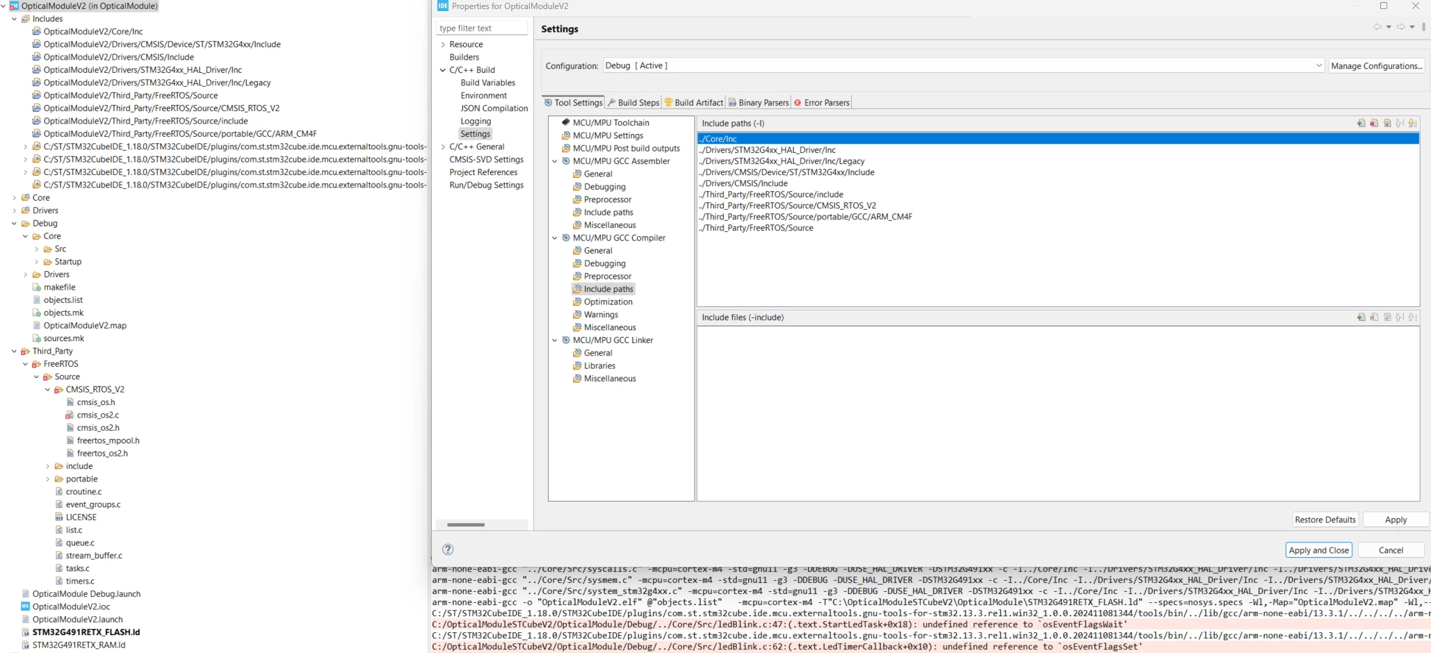

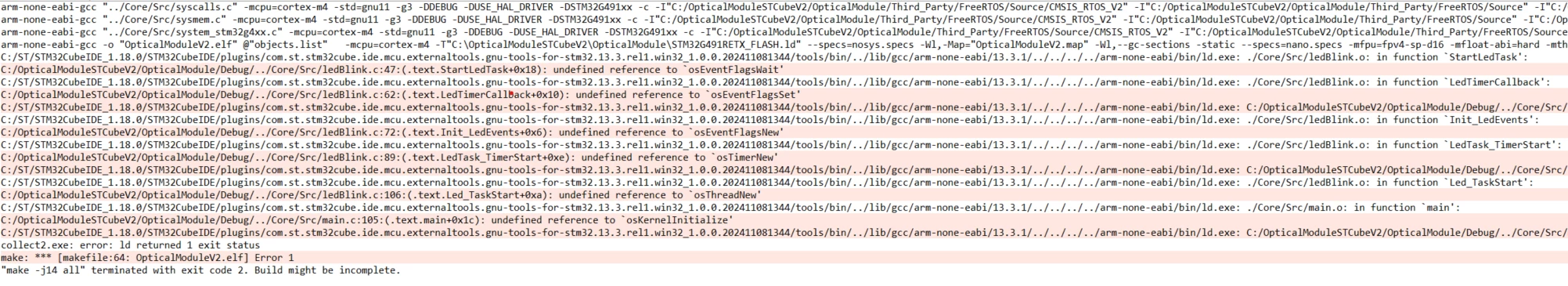

I am trying to create a project with FreeRTOS using CMSIS RTOS V2 without configuring it in the ioc file.  I am trying to turn ON/OFF the LED using thread and timer.  I can build and run the same project if I configure the freeRTOS in STM32CubeMX. But I want to configure it independently. I included all the files required by freeRTOS and CMSIS RTOS V2 for the project.  Attached is .ioc file and error message.

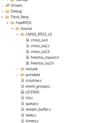

Missing C file: ...\Third_Party\FreeRTOS\Source\CMSIS_RTOS_V2\cmsis_os2.c

This file is included: Third_Party\FreeRTOS\Source\CMSIS_RTOS_V2\cmsis_os2.c

Then please check that the undefined functions from the error messages are present in your cmsis_os2.c:  osKernelInitialize, osThreadNew and so on. Aren't they excluded by some #ifdef?

They are present in the cmsis_os2.c I cannot find any #ifdef.

cmsis_os2.c  hasn't compiled successfully.
