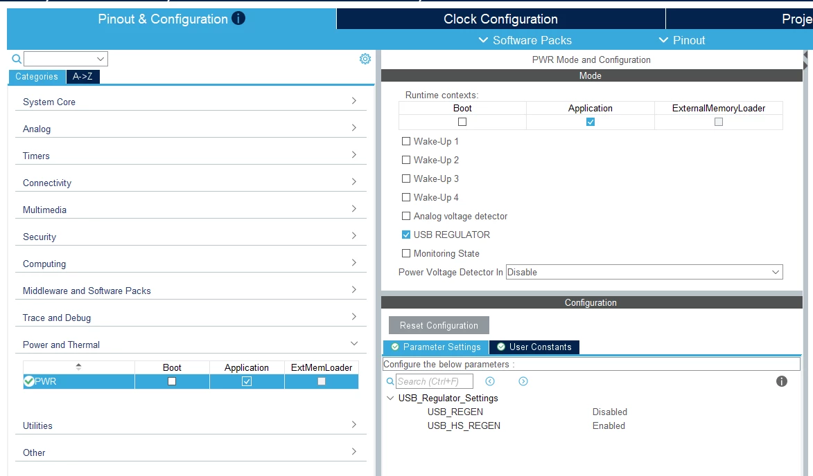

I apologize in advance because this same question has already been answered in another post. I am attaching the link below:
https://community.st.com/t5/stm32-mcus-embedded-software/usb-hs-on-the-stm32h7s3l8/m-p/740800#M56769
In summary, in case you don’t want to read the whole post: to use USB-HS with this microcontroller, it is necessary to enable the USB_HS_REG. This can be done in CubeMX under the Power and Thermal category.
