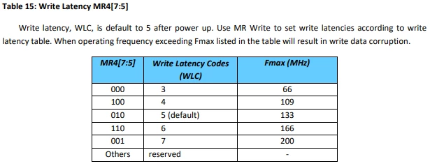

in all examples for the STM32H7S78-DK - including the TouchGFX applications - the frequency for the external APS256XXN-OBR-BG PSRAM is set to 200 MHz:
extmem_list_config[1].PsramObject.psram_public.FreqMax = 200 * 1000000u;
But in the datasheet for the APS256XXN-OBR-BG, see
https://www.mouser.at/datasheet/2/1127/APM_PSRAM_OPI_Xccela_APS256XXN_OBRx_v1_0_PKG-1954780.pdf
it says that the default maximum read and write clock is 133Mhz, see page 16 and 18:
It also says:
"Write latency, WLC, is default to 5 after power up. Use MR Write to set write latencies according to write
latency table. When operating frequency exceeding Fmax listed in the table will result in write data corruption."
Could the be a potential bug in the memory configuration of the STM32H7S78-DK board, which could lead to RAM corruption?

Hello @rk_iot,
The fix has been published on GitHub. You can find it here:
[PRJ] Update PSRAM Configuration in the STM32H7S78-DK Examples to fit… · STMicroelectronics/STM32CubeH7RS@5f0b356
I hope my answer has helped you. When your question is answered, please select this topic as the solution that answered you, as it will help others find that answer faster.
