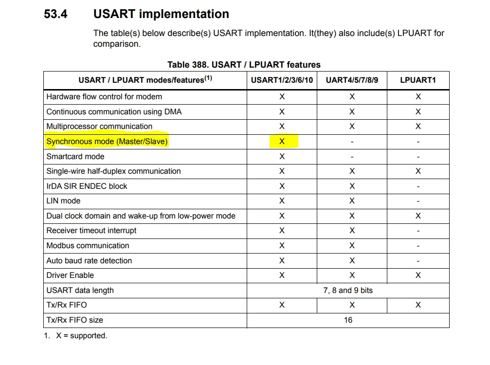

Synchronous slave mode is fully supported on USART1 of the STM32H7B3 MCU. For further details, please refer to Section 53.4 in the Reference Manual RM0455, as indicated in the table below.
