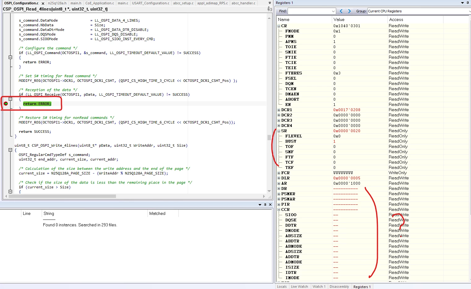

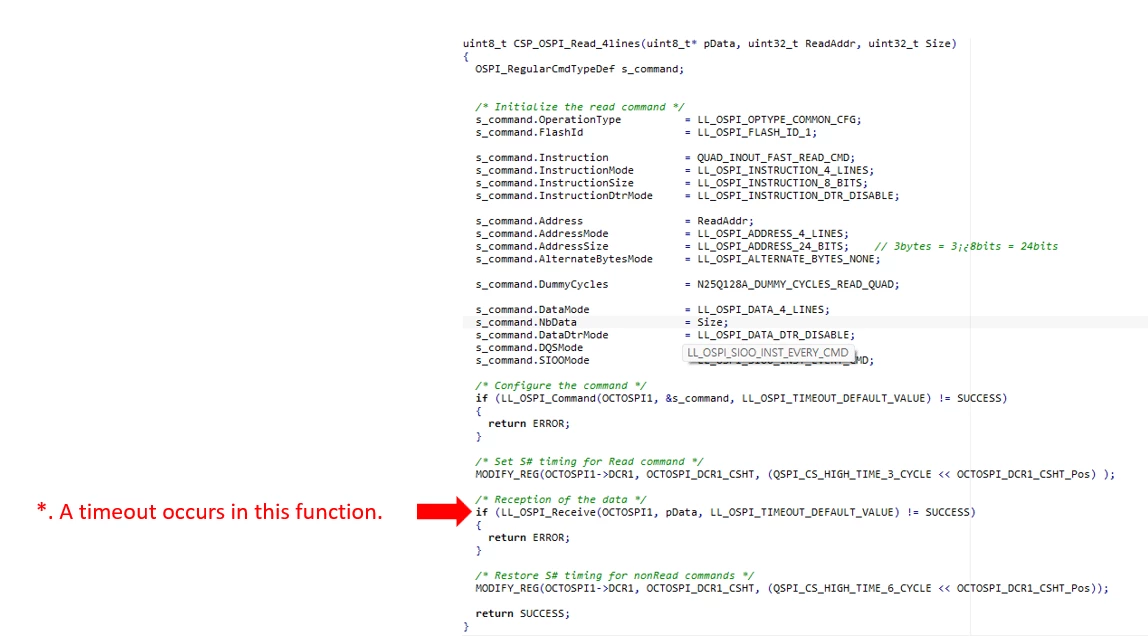

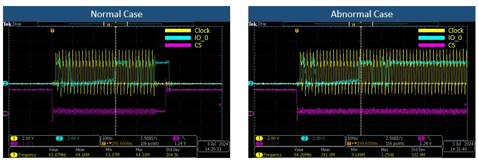

I am using the STM32H7A3ZITQ and have encountered an issue while controlling the MT25QL128ABA1ESESF0IT flash memory during the flash read process. I am operating in QSPI mode. During extended aging evaluations, a 5-second timeout (a busy flag is not cleared) intermittently occurs in the LL_OSPI_Receive() function.

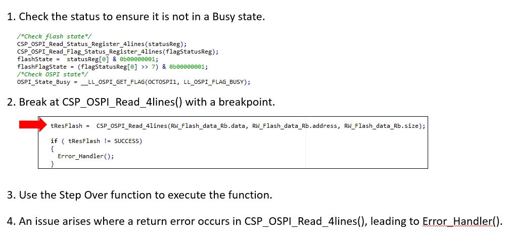

Since this issue occurs randomly, I tried to force the conditions to analyze the problem. I discovered that in debug mode, if I set a breakpoint and step over the function, the problem occurs 100% of the time.

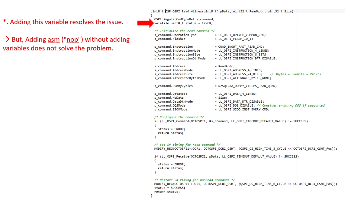

Interestingly, if I add a variable inside the read function, the issue that occurs 100% of the time disappears. When examining the assembly code, I found that adding a volatile variable generates two additional assembly instructions, leading to a delay that seems to resolve the issue. However, attempting to induce a similar delay using asm("nop") did not resolve the issue.
I confirmed that adding a variable resolves the problem. Adding one, two, up to four variables resolves the issue, but adding five variables causes the issue to reappear. This leads me to believe that the problem might be due to something other than a timing issue.

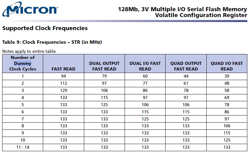

Thanks for your answer,
Here is my initialization code for OctoSPI1. I evaluated the number of dummy cycles from 1 to 15. It only works correctly with 10 dummy cycles. based on this, I estimate that we are operating at a clock frequency of 125MHz(Flash to read only under the condition that the dummy cycle is 10.). I am currently reading only 4 bytes.

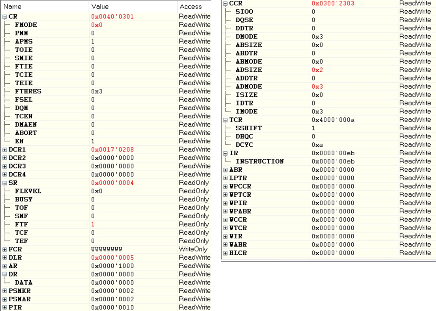

khkimAuthor
Jul 3, 2024 8:49 AM UTC
In the conditions where the issue occurs, the clock continuously generates without interruption, and the data line remains consistently high and CS line low.
Tesla DeLorean
Guru
Jul 1, 2024 1:02 PM UTC
You're pacing this transfer, how much data are you moving, what kind of clock speed do you have on the bus vs prescaler?
What do the registers show?
Don't break-point or put a peripheral view over the top of the QSPI/OSPI, the former at user response rates is problematic, the latter will break FIFO, etc. as invasive.
